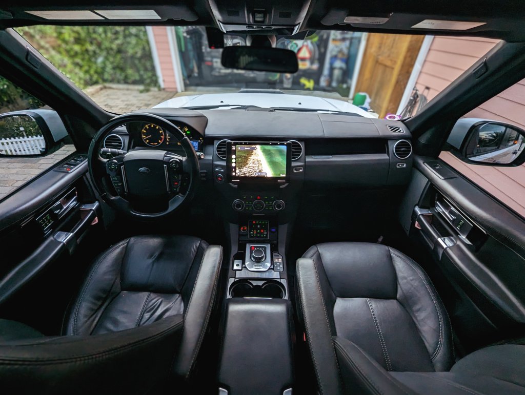

This thread definitely helped me with my install. Thanks!

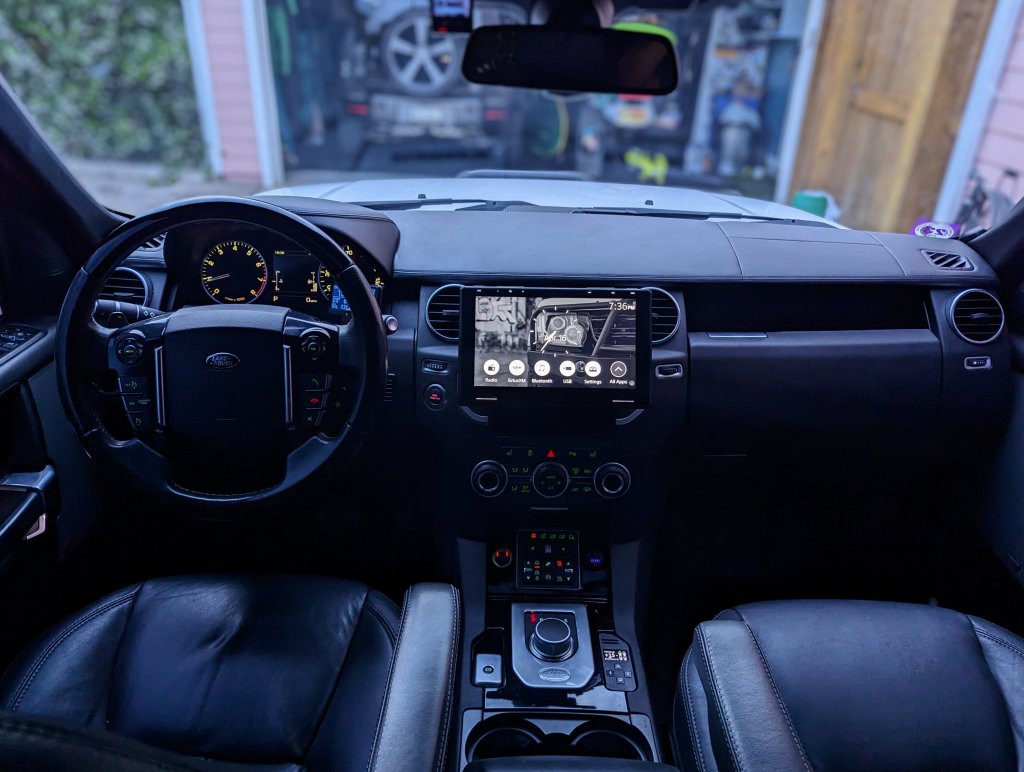

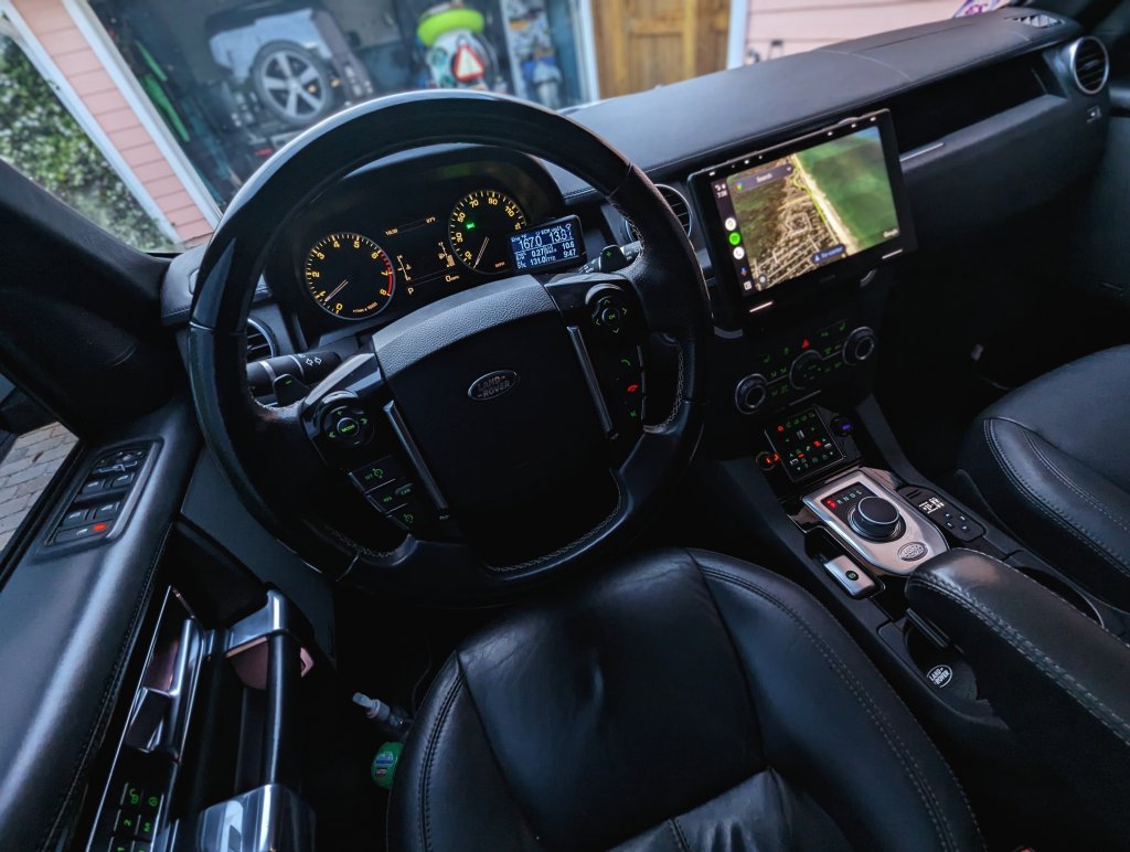

iSurfvilano
Oct 9, 2016
661
420
North Beach, FL
Wider angle. Also reupholstered the pillars/headliner in black. Vinyl for the pillars and a heavier duty fabric for the headliner. I retro fitted L663 Defender visors in there.
