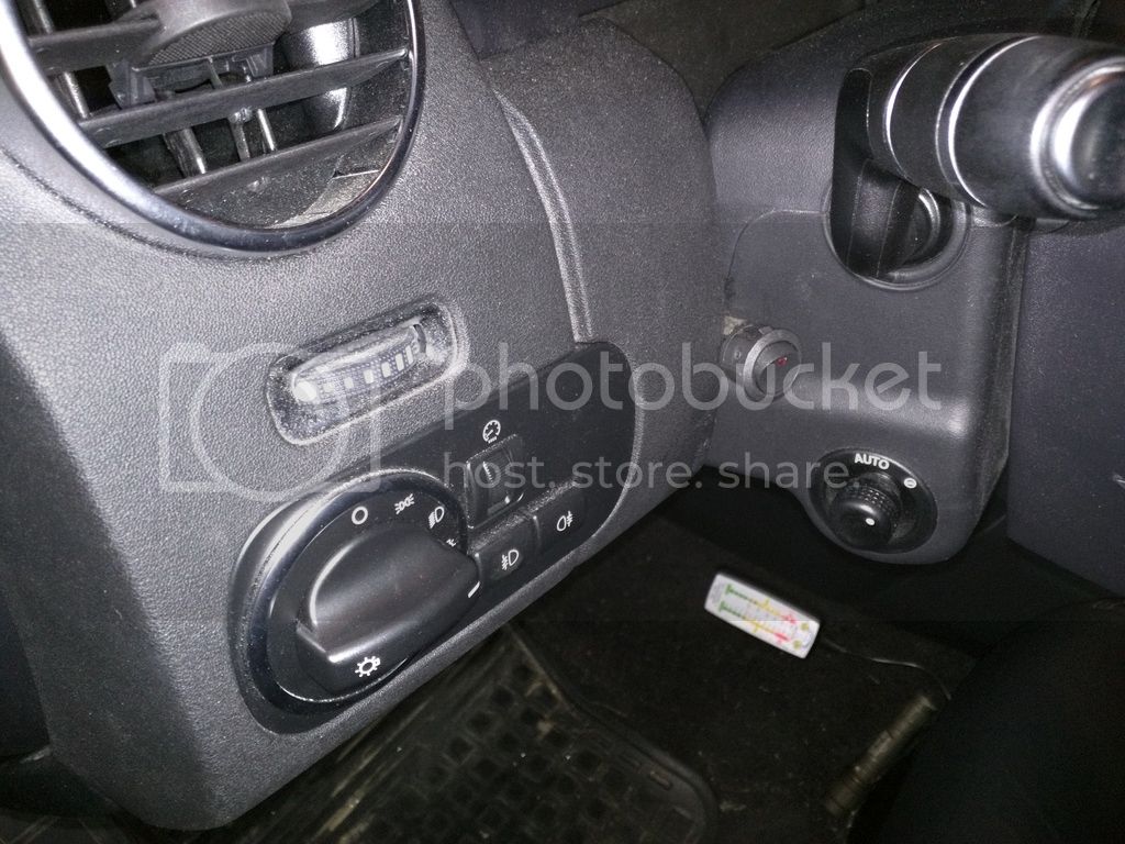

1,694
I was trying to figure out a way to add a switch to the blank area on that light switch module (which pops out).. but behind the blank area is a box with the little PCB on it) So that wouldn't work. Then I was thinking about a steering column switch..drill a hole or something. Found a couple spots that would work for that. The fog light button is not a simple switch or relay, I think it's actually signalling on CAN bus.. so reprogramming that would take some effort.
You could run a relay cable through the firewall up behind the driver side dash and that would be pretty simple. I ended up just wedging a switch between the dash and the column because I didn't want to pull the trigger on a hole yet. It doesn't look perfect, but im the only one who knows its really there and its surprisingly solid, wont move around when I use it. (I don't move my steering column much, so its fine)
