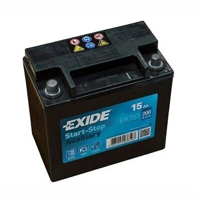

I have seen many posts on the functions of the ECO Battery - but at least from my experience it seems to have no additional function other than the Start/Stop.
Everything will function just fine with a dead ECO battery.
I presume that everything will also be fine if you remove the battery - but I cannot say that from personal experience.
As with any battery - I would recommend removing it once it's dead - you don't want it to leak.
(And yes, even these "sealed" batteries can leak.)
In my case the idiot light during the day is fine - but at night it's too bright and I need it to be off.
So I replaced the ECO battery even though I turn the ECO function off - every time - as part of my things to do until the idle comes down routine.
it's about a 10 minute project to replace the battery.
Battery costs are dealerships are nuts!
Order one from the UK, pay the crazy shipping costs - any you will still be several hundred dollars less expensive that sourcing the battery in the US.
I have had great service from Groves Batteries Ltd, Cheltenham, and others have also had great service from various UK vendors.
It's an Exide EK151.
If your ECO battery blanket has been removed at an earlier time, this would be a good time to reinstall it - I found a really nice option on Amazon.
