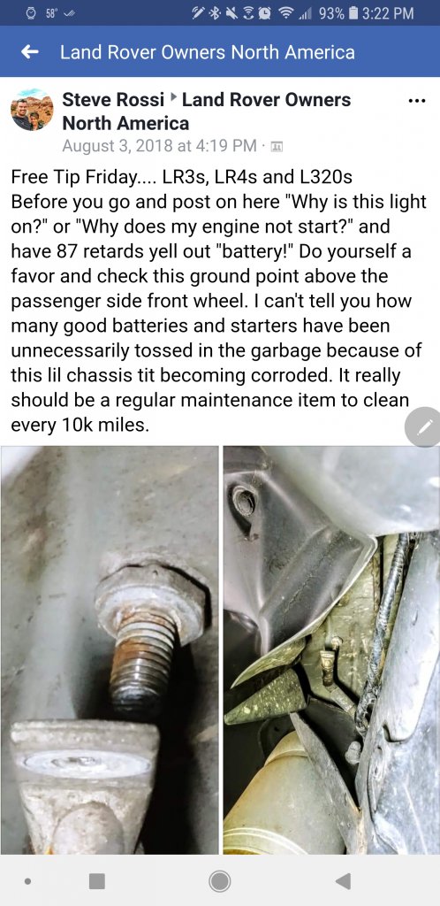

I found this info on the LR4 facebook group and it help me finally solve the issues I was seeing with the charging on my 11 LR4. I had replaced the alternator and battery last April and would still see voltage drop down to 12.2 while running. Initially I blamed it on a bad new alternator so I returned it and swapped for another new one. The same issue popped up again so I started to look at the battery. The battery was replaced at the same time with a new interstate. After swapping to the second battery a few weeks later it would drop down again to 12.2 while driving. If you have the cool box fitted you know when it goes down as you can hear the fans switch off below 13.3v. Another battery replacement but this time to a AGM and making sure the specs were set properly via the GAP tool I thought I was good to go. Well it started happening again after the last cold spell so I looked further into it.
There was a post from a shop owner on FB about how many electrical issues are misdiagnosed on the LR4 due to the main ground cable being corroded. I assumed it would be in a some what protected location as it is on my D2 but it is not. You have to pull back the right front fender liner right in front of the air bag and there you can see it looking up from under the vehicle. When I removed the dome nut that held the ground cable in place there was quite of bit of road gunk that had built up in that area on the grounding point. I cleaned the connection with a wire brush and a sanding block. Reassembled with dielectric grease and sure enough I now have a constant voltage showing that never drops below 13.5
Just food for thought and you might want to check the ground cable.

I found this info on the LR4 facebook group and it help me finally solve the issues I was seeing with the charging on my 11 LR4. I had replaced with alternator and battery last April and would still see voltage drop down to 12.2 while running. Initially I blamed it on a bad new alternator so I returned it and swapped for another new on. The same issue popped up again so I started to look at the battery. The battery was replaced at the same time with a new interstate. After swapping to the second battery a few weeks later it would drop down again to 12.2 while driving. If you have the cool box fitted you know when it goes down as you can her the fans switch off below 13.3v. Another battery replacement but this time to a AGM and making sure the specs were set properly via the GAP tool I thought I was good to go. Well it started happening again after the last cold spell so I look further into it.
There was a post from a shop owner on FB about how many electrical issues are misdiagnosed on the LR4 due to the main ground cable being corroded. I assumed it would be in a some what protected location as it is on my D2 but it is not. You have to pulled back the right front fender liner right in front of the air bag and there you can see it looking up from under the vehicle. When I removed the dome nut that held the ground cable in place there was quite of bit of road gunk that had built up in that area on the grounding point. I cleaned the connection with a wire brush and a sanding block. Reassembled with dielectric grease and sure enough I now have a constant voltage showing that never drops below 13.5

dielectric grease
Just so we are clear, this grease is non-conductive. It may keep moisture out of a connection/connector, but its maybe not the first thing I would put on my main ground. I could be wrong though.

Chalk up another tidbit for the mythical LR4 wiki...good share @DonC. Which specific LR4 group on FB?
Steve Rossi post from Aug 3, 2018 on Land Rover Owners North America group.
mbw - I agree. I grabbed what I had handy to just make sure the dome nut had something on it. I am going back into that area for a hidden winch install here in the coming weeks and planning on sealing it better when I do.
