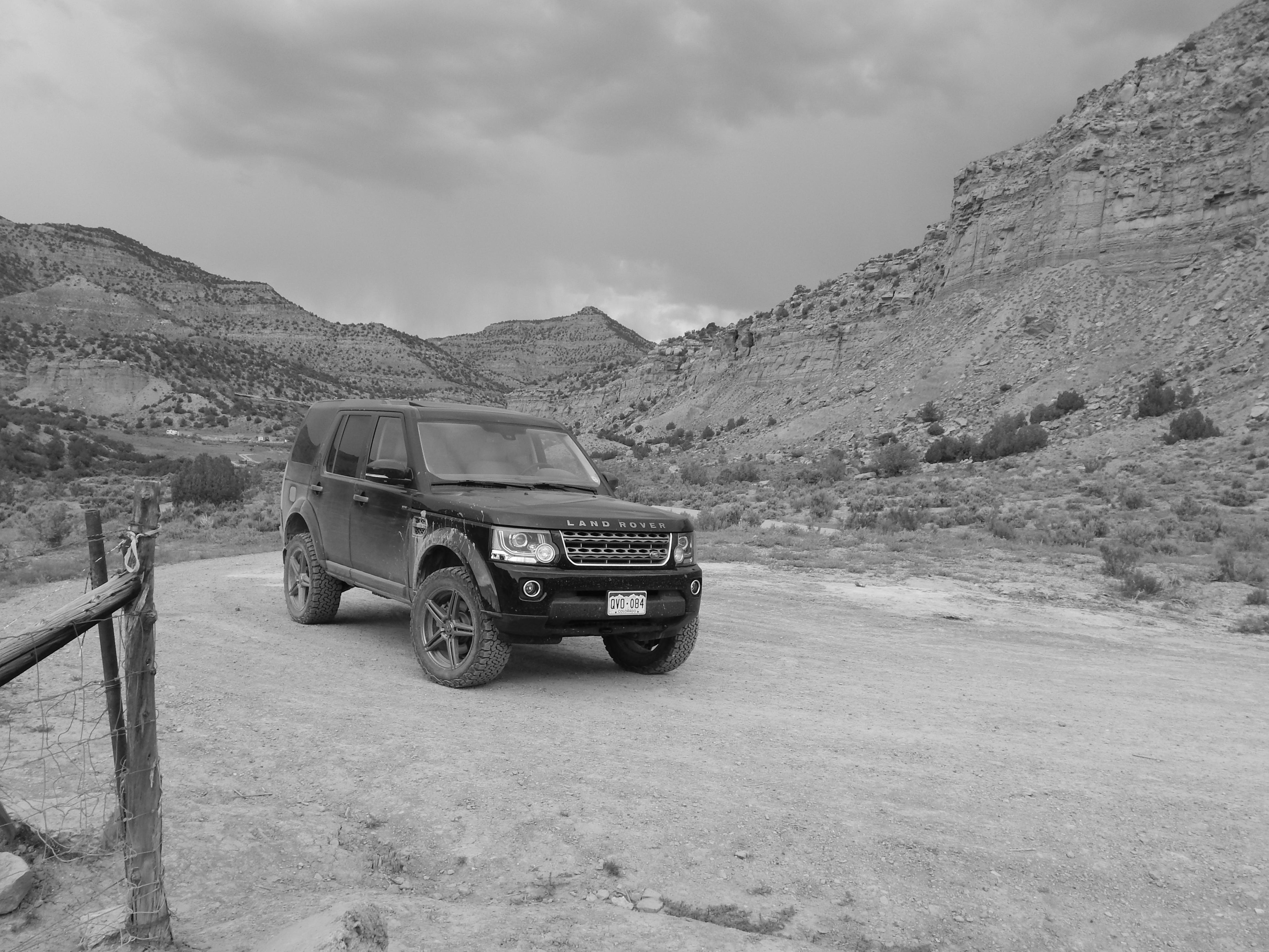

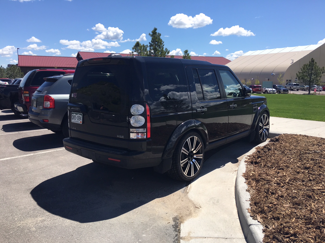

You can adjust front/rear/all points at once on the air suspension. Due to my offroad tires being bigger, I dialed up the "Normal" ride height by 25mm. Doesn't seem like much, but it was huge. Now since it changes the camber, I would only plug it in when you hit the trailhead, and return it to normal back on pavement. Now if you want, you can dial it up by say....15-20mm and then take it to a shop that can align LRs and they'll adjust it to the new ride height and neutralize the camber. I did the temporary trail only solution all over utah, and then when I got home, dropped the 22" Stormer wheels on with street tires and dropped the rig down in a slammed look. Since this is permanent-ish, I had it realigned at the lowered stance. Attached are same truck, different stances. This module is perfection. Easy to use too!
