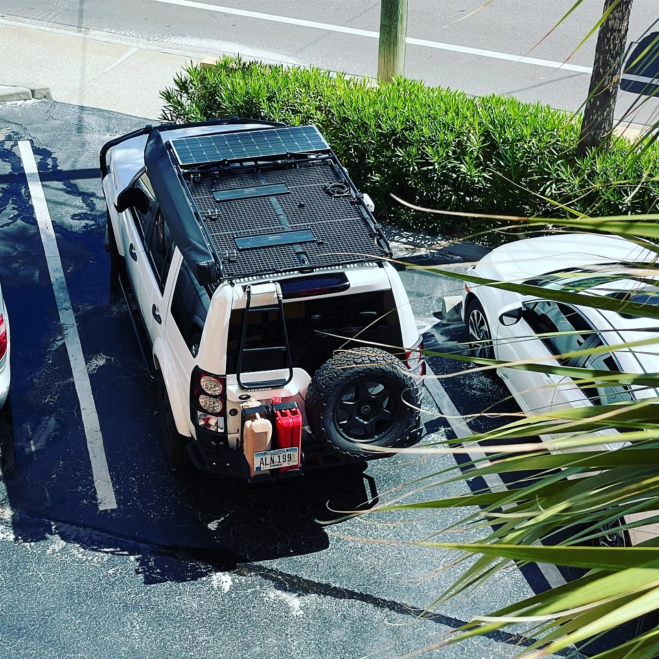

Love my low profile Voyager rack. Super tough. I can jump on it and I am a big guy.
(Polymax chicken coop flooring, some eo2 mounts for cases or maxtraxx mounts, 100 watt panel on gas struts to lift up.)
