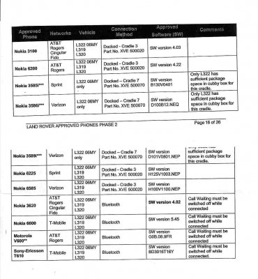

Rover phones
I picked this up today from the dealer; a list of bluetooth and cradle approved phones.
