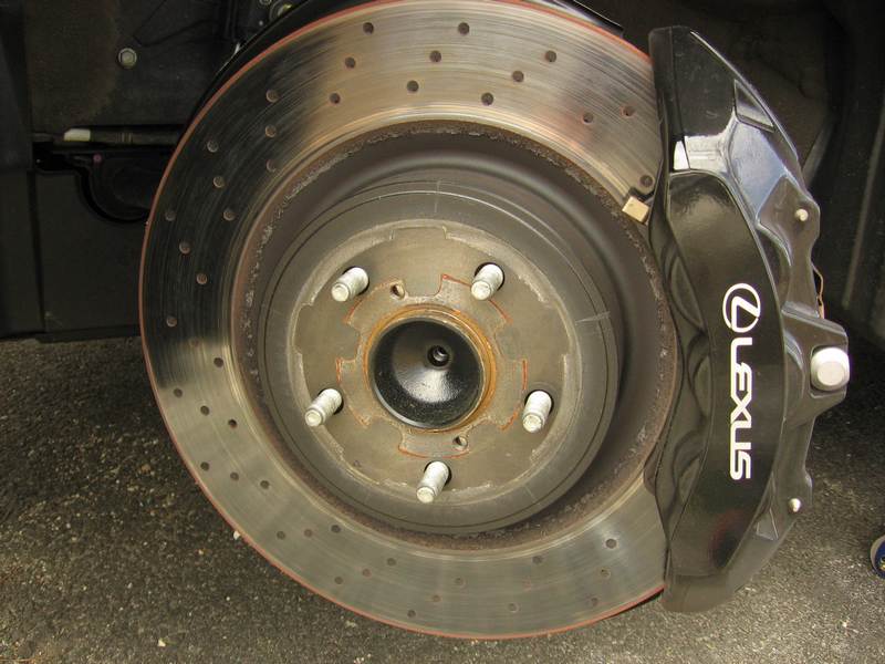

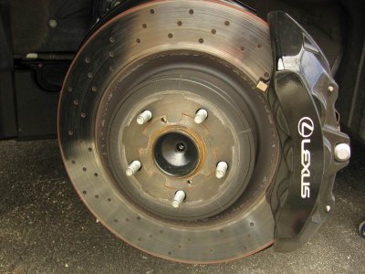

I order them directly from Carbotech. Waiting on a callback from them right now. They may be out of cores to make the pads. I've had a set of the 1521 compound on my ISF for 10k miles now. The stock pads were very aggressive in initial bit and wear and had a ton of brake dust (similar to the LR3) Only thing I noticed after the change was slightly less initial bite, then they come in. Hardly any brake dust with the 1521 compound. I get more dust on the rear wheels than the front on the car. I attached a pic to show what kind of brake system I'm dealing with on the ISF. 6 piston brembo, drilled rotors. I would have absolutely no problem using these on the LR3.

I attached a pic to show what kind of brake system I'm dealing with on the ISF. 6 piston brembo, drilled rotors. I would have absolutely no problem using these on the LR3.[/QUOTE]
Stock calipers on an ISF are 6-*** Brembos? (Big reds) Please tell Lexus thanks for not painting them Fire Engine Red. The black looks great.
geesh...I think you could run kleenex for brake pad material and still have good brakes on that thing.
