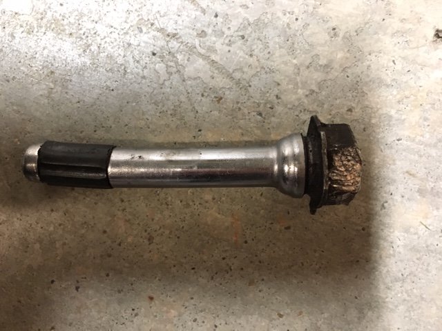

I have a slider pin that is completely stuck. It won't spin nor go in and out. I even beat on it with a hammer to try and unfreeze it, with no success. Any ideas how I can get that pin out to replace it? Thank you all.

Welcome to hell and the reason to service those pins constantly. 99% of the time the pin that is giving you an issue is the one that has the rubber grommet on it. The rubber swells/degrades and the pin no longers moves, it can be a real bugger to remove as you know. I had success clamping a large set of vice grips on the bolt end of the pin and then hammering on the vice grip outward. The grips allow you to twist and turn the pin. If it doesn't come this way you may need to remove the caliper to the bench for more extreme options. You may need a new or reman caliper. If and when you get the pin out clean out the hole, ne pin, new grommet (or ditch it and live with some noise) and ONLY silicone/ceramic
grease. Do not use
synthetic grease "safe for rubber". Its not.

So I finally got around to handling this. I ordered replacement pins and rubber boots from AutoZone.
In addition to following KTM525's instructions, I also had to resort to taking a torch to it in order to get it to budge at all. But I was careful to shield off the brake lines and all other pertinent hardware before firing it up.
The problem now is that the aftermarket pins I received are longer and seem to have a larger diameter than the ones I pulled off the truck. I then ordered a set from Advance Auto, which came in overnight, and they too are larger (like the ones from AutoZone).
Has anyone else experienced this?

What year is your vehicle? There is a front brake vin break on the 2010s but as far as I can tell that is only for pad thickness. I have ordered Carlson caliper pins from Rock Auto with no issue.
Perhaps previous owner downsized your brakes to fit 18" wheels?
