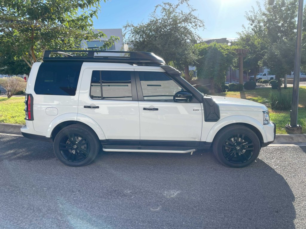

And this particular LR4 I've got has an OEM roof rack (wind drag?)

The snorkel? and roof rack are going to drop your MPG a little bit.

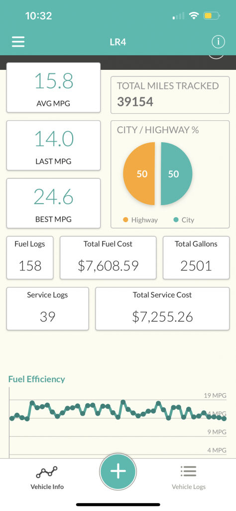

My average from 158 fuel logs and 39k mi. is 15.8mpg. Lowest was 12.5, usually around town I get about 14.

I'll go ahead and do a small highway trip, about 40 miles, I'll fill the tank up with premium gas, reset the odometer then refill again and see how it does. I'm running on 255/55/R20 Pirelli Scorpion All Season, OEM was 255/50/R20, I wanted a bit more of profile on the tires for *** holes and whatnot. As for the snorkel, there's only one on the passenger's side. And I just realized my tires were underinflated to 30 psi, it does get really hot here on the south around this time of year so I'll do 35 psi on the front and 41 psi on the rear.
