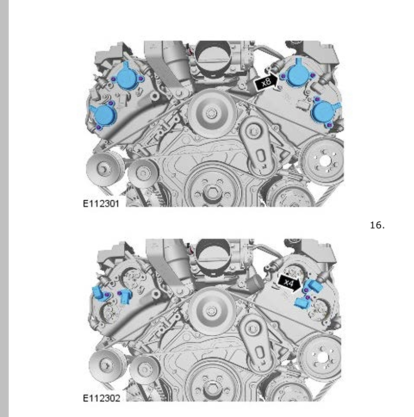

thanks, I'll start digging in later today. By any chance, do you have the replacement procedure for the solenoid anywhere in any workshop manual? I have a 2010 pdf that's not super helpful but maybe there's something better out there. Much appreciated!
jlglr4
Mar 19, 2019
1,017
543
Northern California
I’ve never done it before. My 2011 manual doesn’t even have a table of contents, and I can’t find the right section with keyword searching, but in my 2016 manual, it falls under the timing drive components section. The part about the VVT solenoids is summed up in a single figure basically telling you to remove two bolts and pull them out. Looks about as simple as it gets. I don’t think you even need to remove much to get to them if my memory is correct - they’re mounted right on the front of the timing covers.
Maybe someone else here has some real-world experience.
