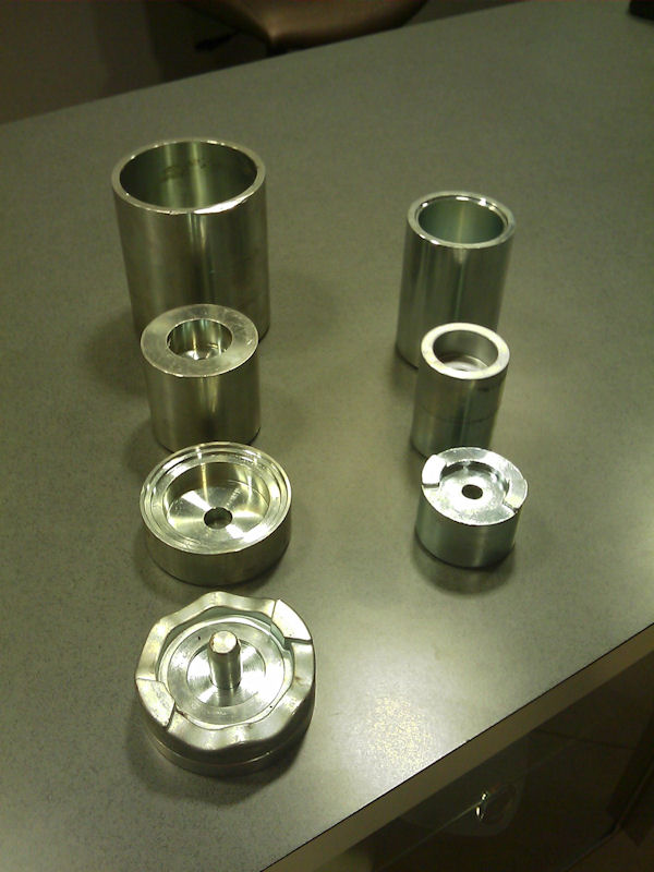

Thank you kindly... I spoke to my stealer this afternoon. I ask if I might be able to measure up there special control arm bushing tool.....and they said they had broken there special tool for the installation of the bushings, and he would check and see if the new one was in, and if so, I could measure it up.
I will measure the new one up and post the data here. I will go as far as providing a CAD
drawing for anyone who request it.
Thanks,
Mitchell
gmfain
Sep 2, 2009
58
16
Went to the stealer this am, and he let me measure up the install and uninstall tools. Except for the broken one. He said they are have all kinds of problems installing and uninstalling the bushings. He printed the procedure out for me. I will get it scanned into the computer. If anyone wants a copy, I'll be glad to email one....
Of course they did not have a full set of bushings, so they are ordered them. I'm suppose to pick them up next Saturday, the 12th..... So I have a week to draw up the tools, and make them....
I also took a picture of the tools.

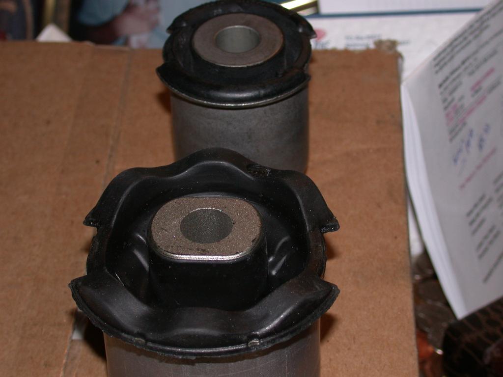

Hey guys, I picked up the bushings Saturday. Here is a shot of the bushings... I'm out of town this weekend, so I won't start on the repair until next week....more to come...
Mitchell
