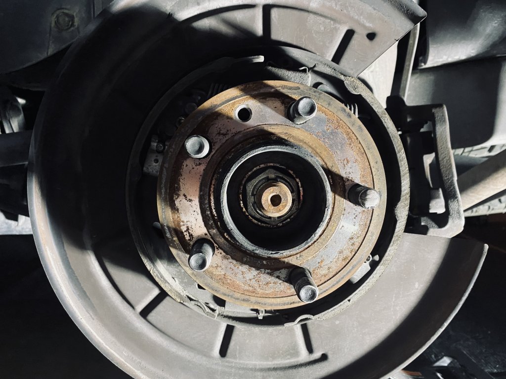

I broke a lug stud a couple weeks ago and I’m having a difficult time finding a replacement. It appears these studs can only be purchased along with a new hub.
However, my hub is fine and I don’t want to spend a $250 (timken) or $700 (LR) for a replacement hub when I don’t need it.
Yes, I realize I still need to pull the hub to replace the stud. I still don’t want to replace it.
I’ve found studs that appear to be the same size (M14x1.5) and about the same length it’s hard to know if the knurl length and diameter are correct, or if the splines are right.
I picked up a couple dorman studs from autozone (just to compare in person) but the knurl length and diameter isnt right.
Rimmer Bros and the other “LR focused parts sites” appear to have studs for Range Rovers, freelanders, defenders, but not the LR.
I’ve found a couple threads on the forum but nothing with conclusive information.
Anyone got an idea?

They’re just pressed in. You don’t repair the stud, you replace it- and it’s basically a bolt with splines you can press back into the hub with something like a joint separator (some people seat them by placing a bunch of washers on it and using a lug nut to essentially “pull” the splines into the hub.
This is pretty standard on tons of vehicles. It’s important to use the right stud though.
As it turns out, Lucky8 has the hub assembly with studs already pressed in at a reasonable price. I guess you can replace this without pulling the bearings out.
I really tried as hard as I could to find the studs but when I called Lucky8 and they explained to me it’s an easy and inexpensive replacement (I was mislead about the complexity and cost of this replacement on a Facebook group). I ordered this part. Easy-ish stuff. Will report back once I’m done swapping out.

I’m my experience with similar designed hubs, albeit on a larger scale the hub is machined then the studs are pressed into it to form a mechanical fit. Similar in principle to a friction coupling. This provides for a very “tight” and robust installation without the need for welding etc. the down side is that it’s essentially a one and done if a stud breaks. You can of course replace studs but generally the fit is not as good as the original. It’s a great get me home option though :)
Do you have the part of the stud that broke off? Or was this claimed by Mother Nature as payment for overland passage. The reason I ask is you can tell a great deal about the failure method by a good look at the surfaces where the break occurred.

After the climb into the Sierras up to Coyote Flat and back down (which battered all 4 of my brand new wheels pretty good) I got on the highway and noticed a sound. I stopped the truck to do a quickly once over and noticed a couple loose lug nuts. When I tightened them up one snapped. So the stud it broken off inside the lug nut which I have.
Reality is- it’s probably best I’m replacing all of the studs on that hub given the other ones might be stressed and vulnerable to breaking as well.
