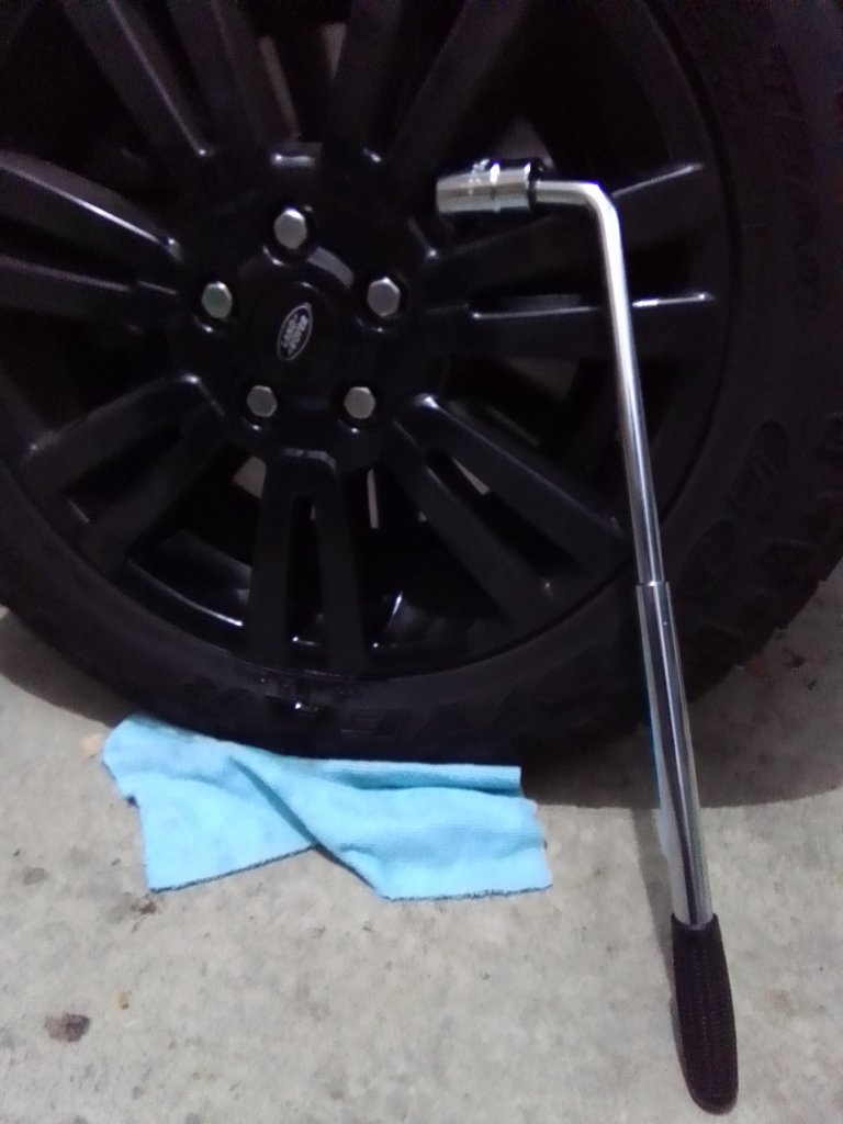

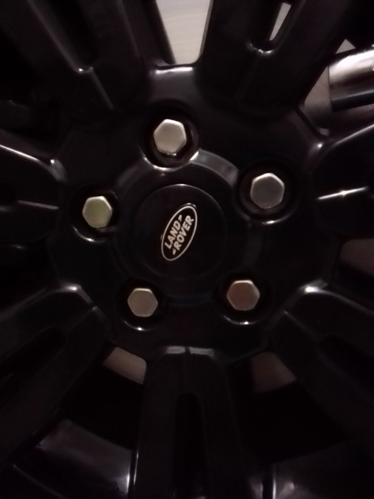

As you can see, the wheels and lug nuts look in good condition. I'm also using a pretty heavy-duty lug wrench. I've shot all of them up with WD-40 and am going to let them sit overnight. Is there something I'm missing here? Could they be locking in a way that I am just not seeing? Anyone run across something like this before? You would think that at least a few of them would move, but every last one is on solid.
My next move is to take it to Discount Tire or Les Schwab and ask them to rotate my tires. Maybe they have the tools and know how to get them off. If so, I'll just request that they put them back on loose enough that a guy (meaning me) could remove them by hand with a lug wrench. I might even let them know I'm planning on doing a brake pad change later that day and I want to be able to take the tires and wheels off.

Do you have another bar you can slide over that one to provide more leverage?
When you get the nuts off you may find the wheel hard to get off still as they can corrode to the centre of the hub. A firm kick with the bottom of your foot at the bottom of the wheel with your back to the car usually works. When you put it back together put a smear of high temp grease on around the centre hub.

If you plan on removing wheels often or changing over seasonally a decent quality cordless impact gun is a good investment. About $2-300 for a half inch drive Mikwaukee or dewalt . There is 1150 ft lb of undoing torque on the Milwaukee so be careful putting nuts back on if you go that route and hand torque as mentioned above.

They sound over-tight. Put a pipe over your breaker bar to extend the leverage. An alternative is to use a torque multiplier tool that is commonly used for big rig type lug nuts.
