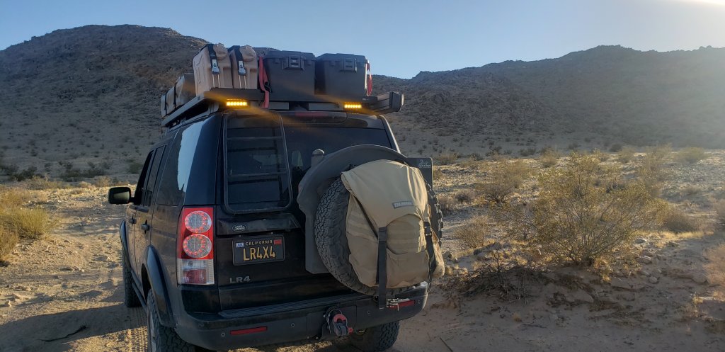

I recently put on the Terrafirma tire carrier and I'm digging it a lot. I combined it with a titan fuel tank.

There's a few mods that you have to do to make it fit properly since it was built for a jeep 5x5 bolt pattern. I got a pair of 5x5 to 5x120 25mm wheel adapter, which happened to be a smidge too thin. I ended up chopping the wheel studs on the tank and got shorter lug nuts and now it sits perfectly. I other than minor mods to get it fully functional, it's awesome. I remove it when I'm not off roading.

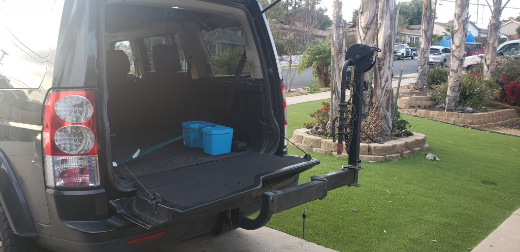

Just get a swing out bike rack. I just sold mine 3 weeks ago. It was an older yakima 4 bike carrier that swings out at 90 and 180 degrees. The rack base also rotates 90 degrees so the bikes will be parallel to the side of the truck.
