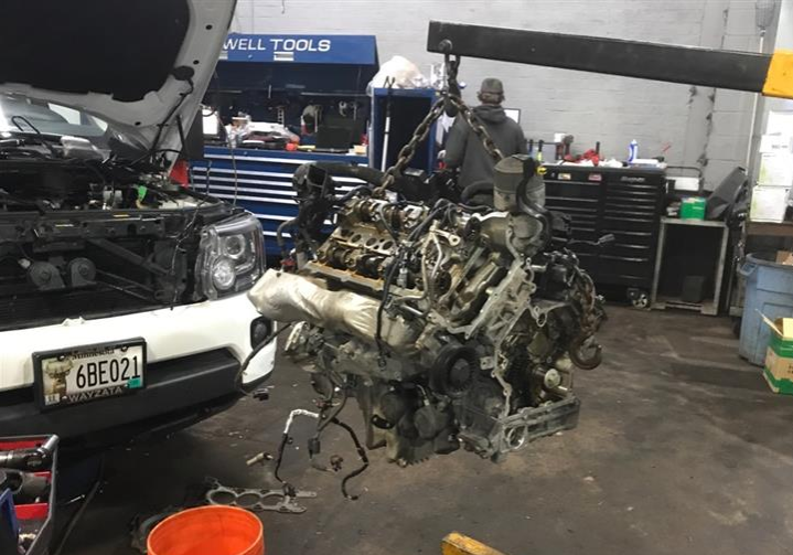

@ryanjl I think you are correct - even though it was maintained at dealer the interval matters. Got a shot from the tech with the motor out. He dropped the oil pan and cleaned that out of all metal fragments from the camshaft. The drivers side cylinder head came in from import dissmanter in North Carolina and he says it looks like new. Now it's reassemble time. Mentioned before also doing the water pump and now crossover since it's torn apart. I appreciate the commentary and responses, it has proven to be good therapy...

Without a doubt, get everything done now that you can. Clean up carbon build up, plugs, water pump, etc.
Interesting to see just the engine pulled like that. I thought they would pull the body, since it's "so easy" to do.
Ditto on that as well, because if I ever yank mine I would be bringing it out the top as well.
