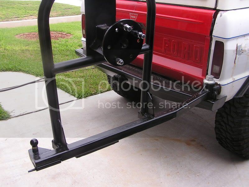

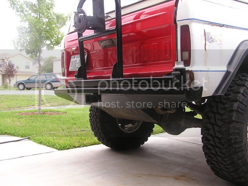

I built a tire carrier for my bronco. One feature that I really like is the ability for it to pin open as well:

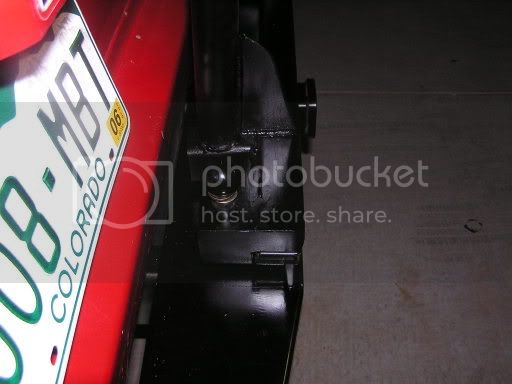

And I used a pin and a door latch to fasten the swing arm shut. I didn't want my 35" tire bouncing down the road if one of those failed.
Just some design ideas to think about.
It would be nice to put that on the other side so as not to block the only low spot in the glass, but I know there would be clearance issues there with the tailgate.
Just some design ideas to think about. It would be nice to put that on the other side so as not to block the only low spot in the glass, but I know there would be clearance issues there with the tailgate.
J.D.
Nicely done. I was considering the pin for locking it open as well. I am considering a shorter version similar to the length of the Rasta version to save weight and length when open.

I think the smaller arm is good. There is considerable leverage in a long arm!! If you wanted a Jerry can, add another arm on the other side.

Thanks. The concept modeling work is done in FormZ. Next step is to convert it to Catia if needed. after revisiting this, I think the shorter arm makes more sense. You are dead on about the weight. Put a jerry can there full of fluid...it all adds up.
