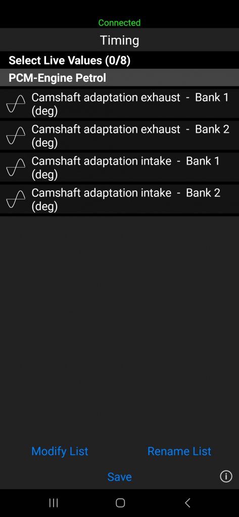

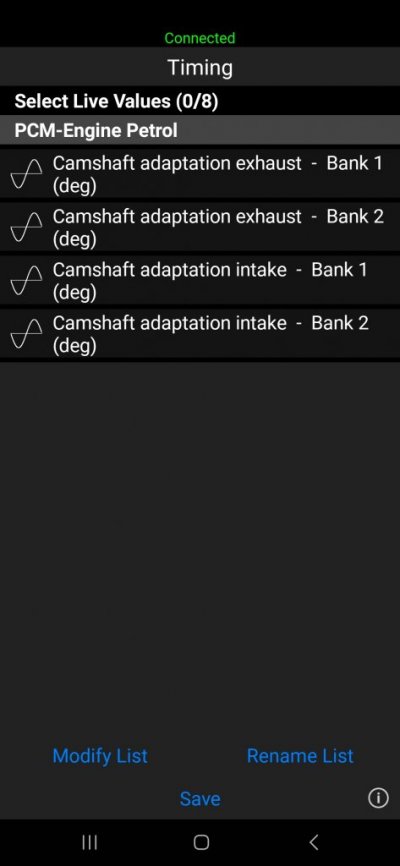

Do you mean absolute value or delta between the two banks? I always thought our cams were continuously varying based on load, engine speed, etc ?

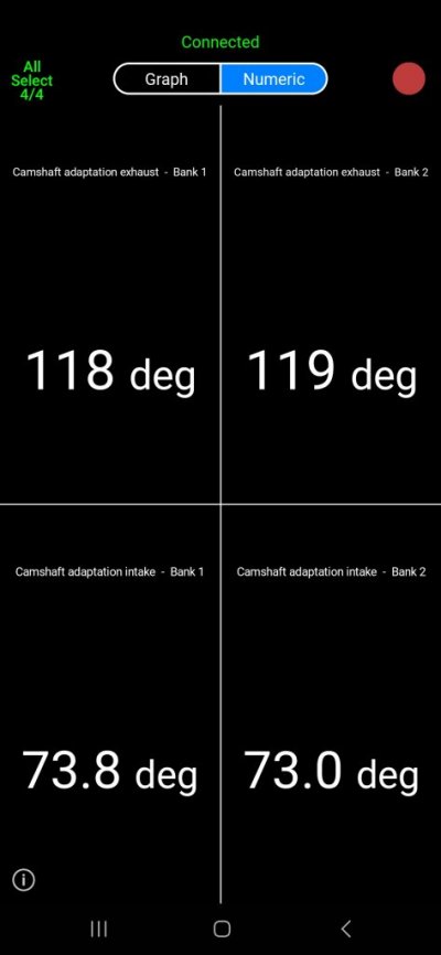

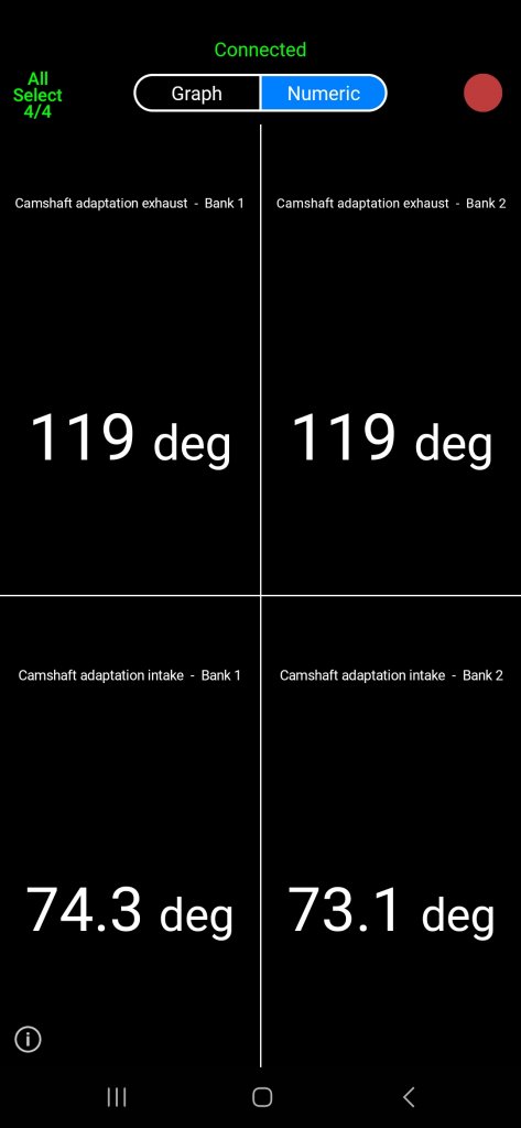

Here are those values from my Gap:
Values after a 1 mile drive to highway on ramp:
Values after warmed up on highway driving:

Yeah, my issue is remembering to take those values right when you start it up and then measuring those values after it warms up by getting it up to temp. I was watching those numbers on my entire 22 mile drive into work and it varies within a 1-2* change.
Also keep in mind, I recently serviced it with pulling the heads and redoing my timing, and it's spot on tight with zero play. My numbers are also very dependent on how my truck behaves. So with that said, your numbers will be different, but the variable of change shouldn't vary too far from the 1-2* change from startup, drive, and at temp driving for each bank and between banks. If that makes sense...
