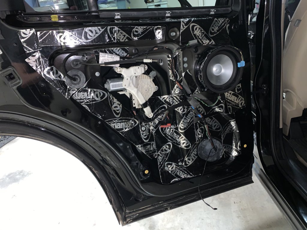

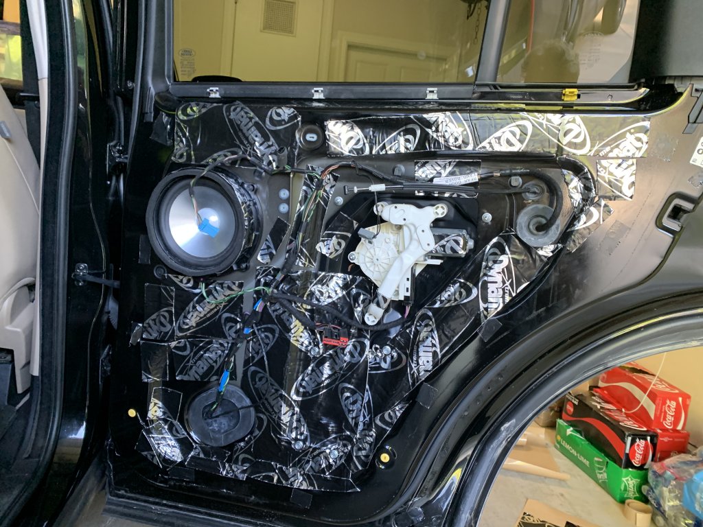

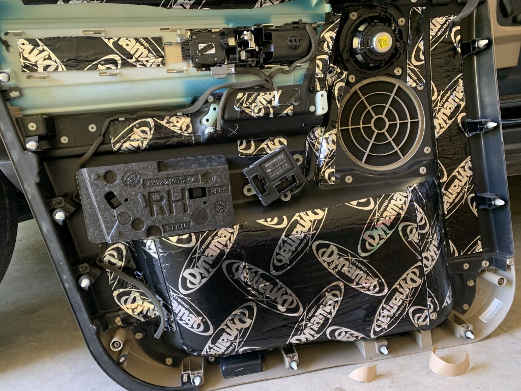

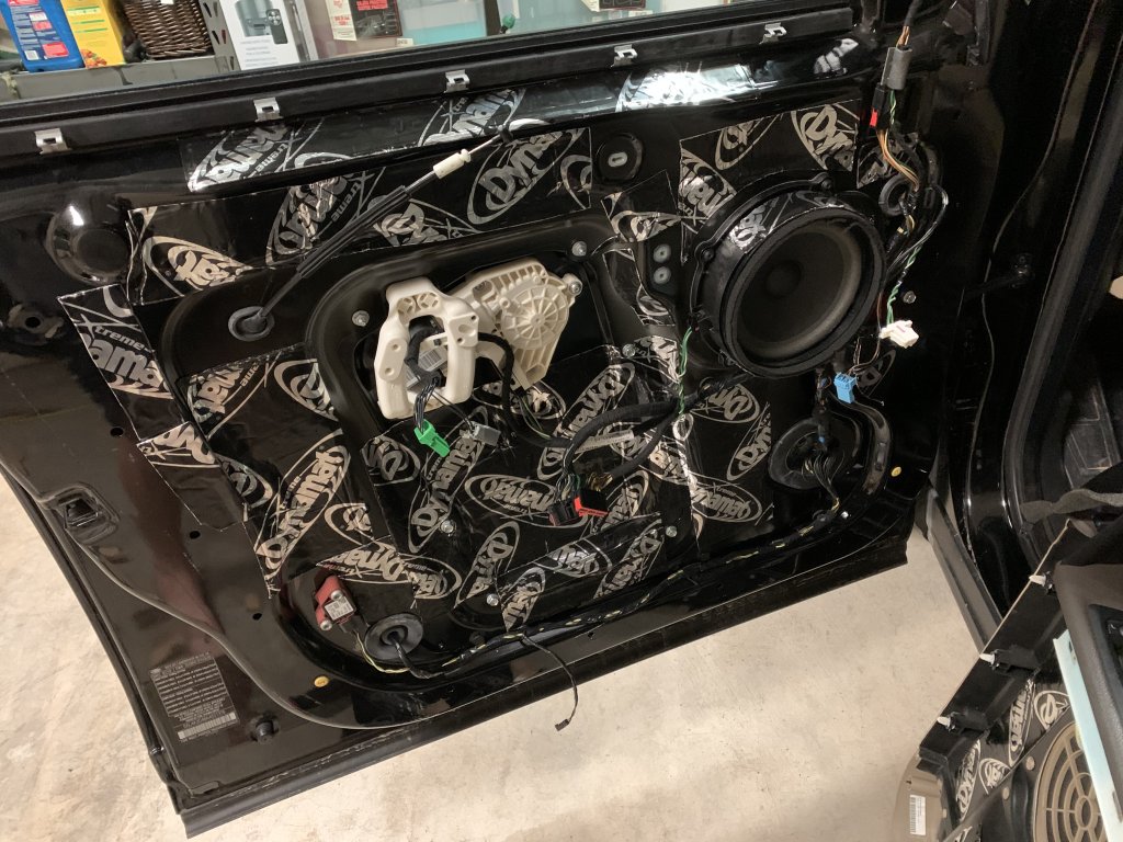

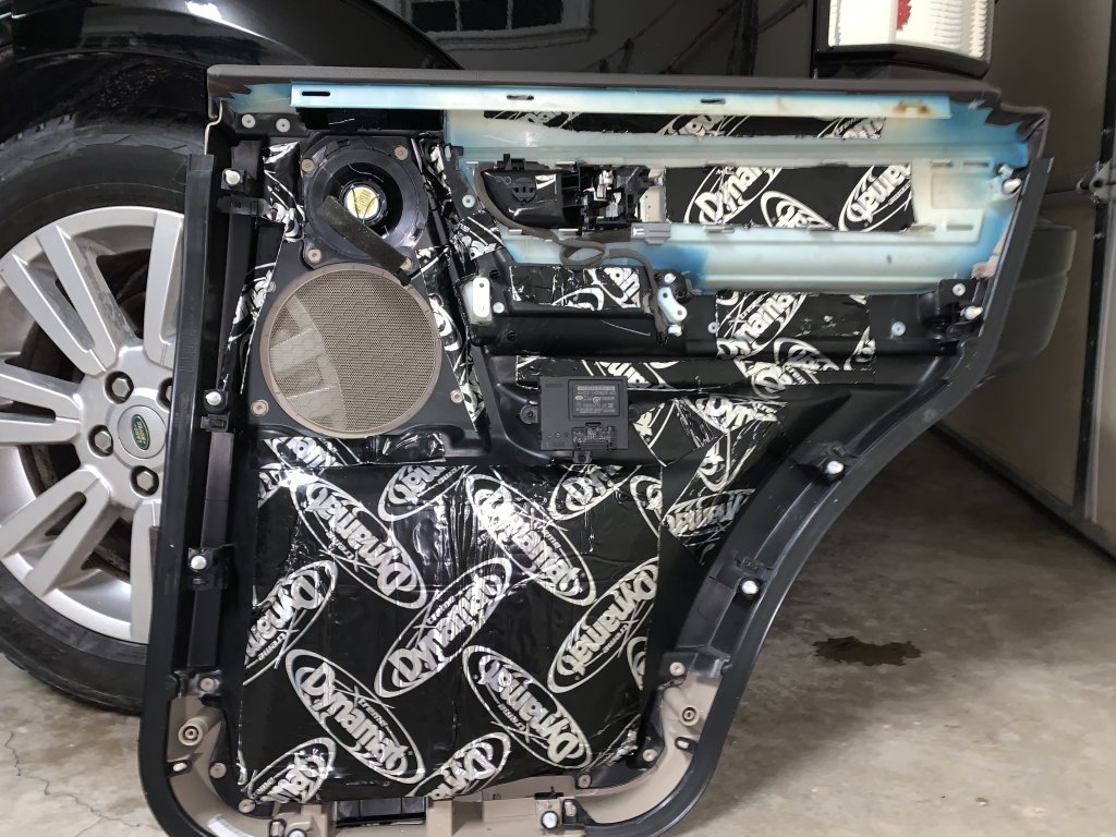

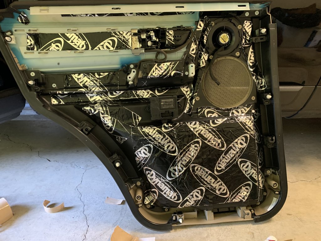

Being bogged down in all the corona virus crap and stress I thought to my self, what a great time to start my very first upgrade project on my 2010 hse lux. I decided to do door deadening on my 480w Harmon/kardon Logic7 System using dynamat. Because I’m a sound ***** and I have my bass setting high I got a lot of door rattle and anyone else who is like me I highly suggest you do this. I started by buying the dynamat extreme pack consisting of 36 sq feet of sound deadened off Crutchfield. First thing I did was take off all the door cards. Then detailed and cleaned each door card as well as wipe down the surfaces that the deadener would be placed on. Then I applied as much deadener that was needed at points on the doors and on the door cards. Any plastic pins were replaced with the correct item with the rubber seal to keep air compression for bass and all unnecessary holes were covered with a strip of duct tape. over all once the job was done it made a significant difference and I still had 2 whole sheets of deadener left Incase I want to add. There was still some rattle at in the 70-73hz zone on very high volume but a massive improvement of what it was prior. Tools I found most useful during this job was a roller to roll all the deadener on and make sure it doesn’t come off, rubbing alcohol to wipe down surfaces duct tape to cover up air holes. ill link the photos of each the door/door card i deadened Incase anyone wanted to follow the general areas I hit, I also recommend hitting the areas that rattle the most and distort sound.
