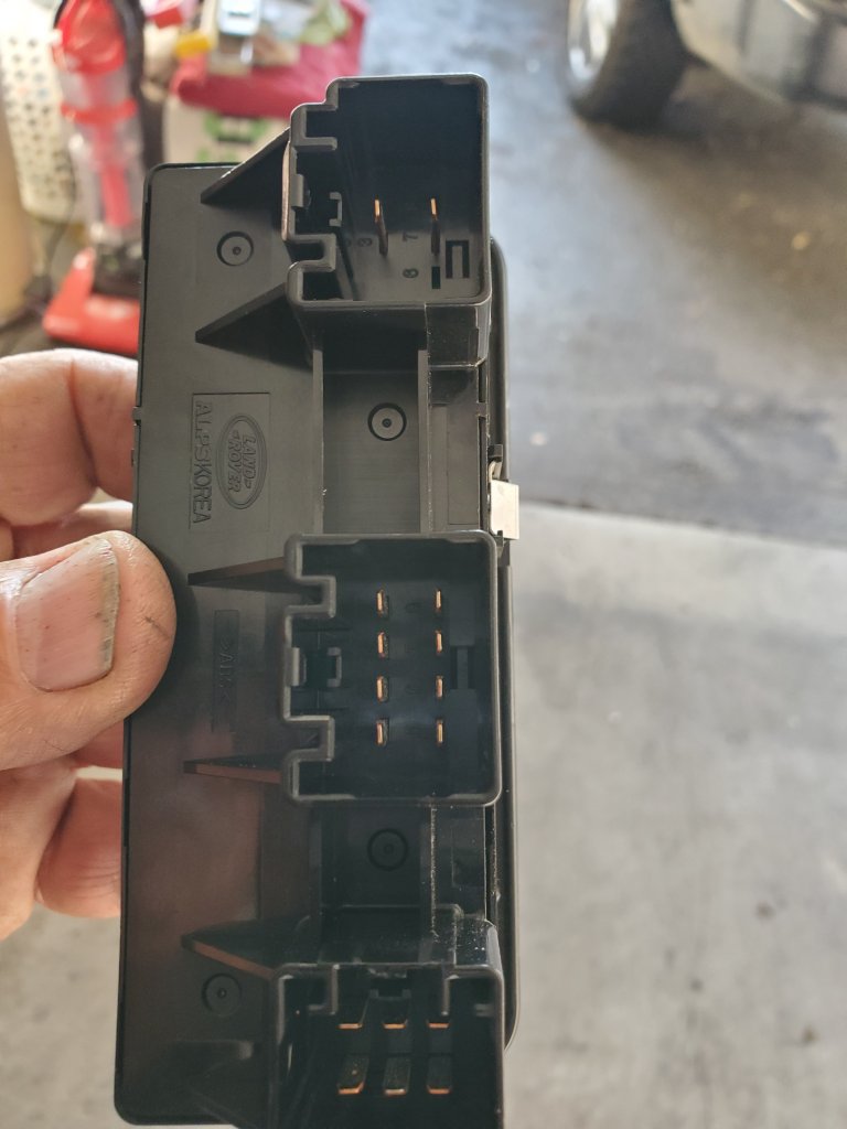

Had the same problem on my LR3, found a switch at the local wrecking yard. Installed it and no change, then I found the fuse block and the
fuse had blown. It specifically says DRIVER WINDOW SWITCH. Replaced it and it worked.
