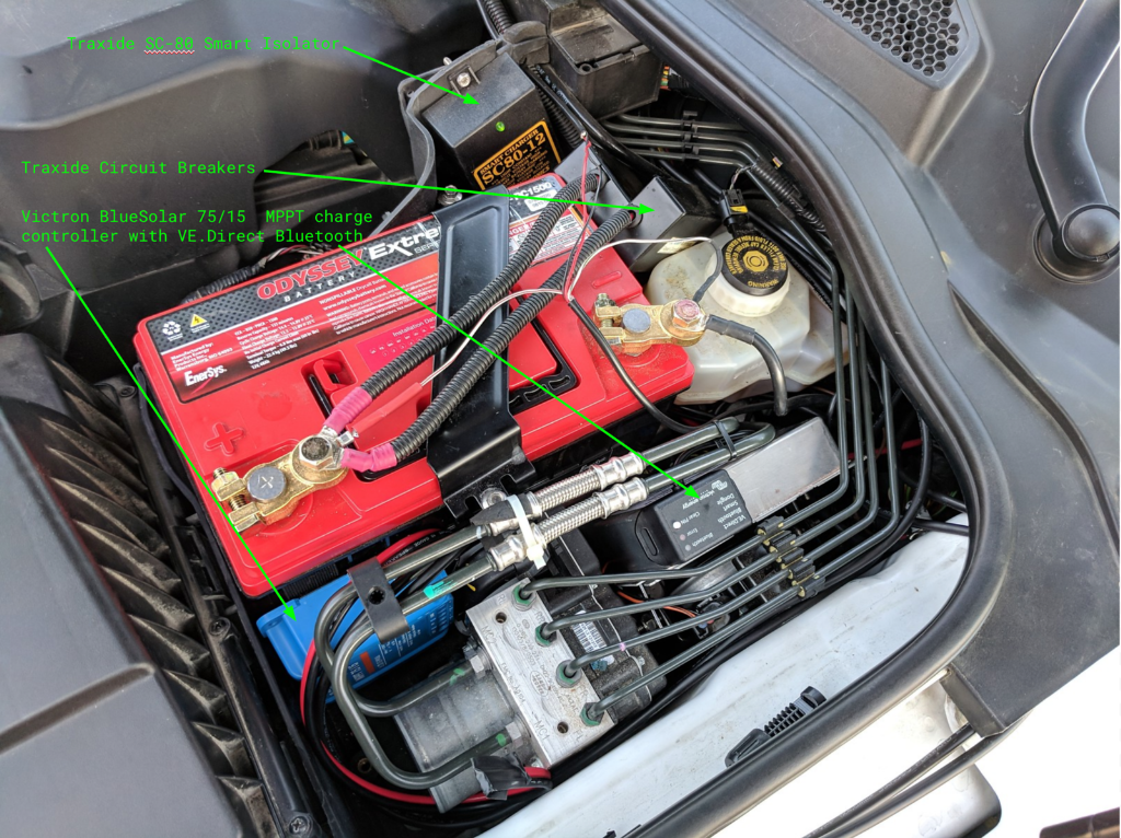

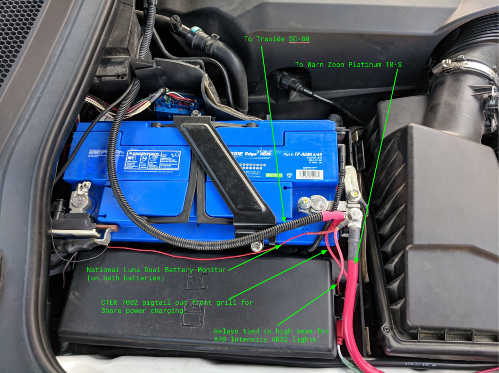

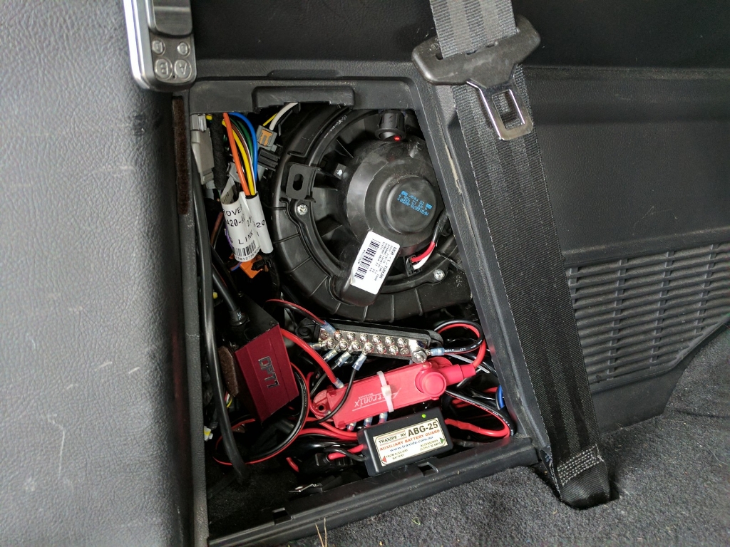

    I have the Traxide SC-80 setup with a separate solar charge setup.
    [​IMG]
    [​IMG]
    [​IMG]

    That's an impressive looking setup.
    I need that. Well, I need half of that. All I really want is a live Aux port in the rear, actually. But I have to admit, it seems intimidating to get there...
