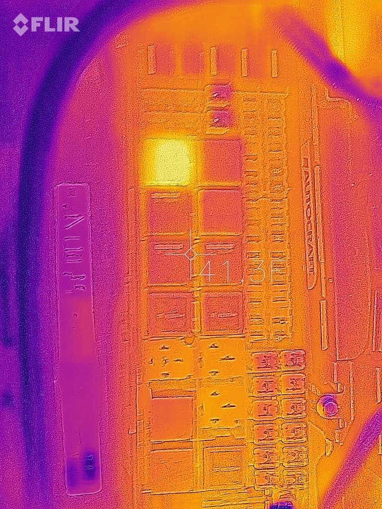

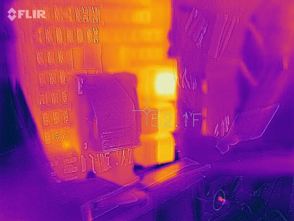

We had a similar issue with our 11’ lr4 lux hd. Drove fine to keystone and then cut off as we pulled up to a light in town, electrical and engine dash lights popped up. Same thing happened a few minutes later making a slow right turn. This was back in January’s and we’ve been on a number of road trips since without it coming back. It’s pretty unnerving hearing yours cut out at 70 and lose brakes and power steering, we frequently travel roads where that situation would almost certainly end in a fatal accident.
Last I fooled with it I was looking for grounding issues ect. I bought a flir one pro to look for hot circuits but haven’t dug in too much passed that.
First pic is the engine electrical relay, engine is off but it’s not fully asleep. Second pic is the 12v aux power in the rear.

May or may not be relevant, but that's an interesting piece of data nevertheless. And you can get IR thermometers pretty cheap these days. Not as cool (pardon the pun) as a FLIR, but might be helpful.
What conclusions did you draw from that IR data, @blake aiken ?

Maybe ignition switch or relay (or other ignition system problem)? If it were alternator or battery, you wouldn’t expect everything other than the engine to stay on - usually its the opposite - engine is the last to completely shut down. Fuel supply - you wouldn’t expect that to affect the ability to crank as someone above mentioned (OP says he hit the ignition switch and got no response). Possibly relay is overheating, but then still working once it cools off?
A few people had mention a grounding issue at the starter may have been the cause. It was over winter so I wasn’t about to miss ski season to work in a cold garage. I’m hoping to wrap up a few house projects soon so I can get the cars in shape
I got my iOS flir off eBay for $275.
