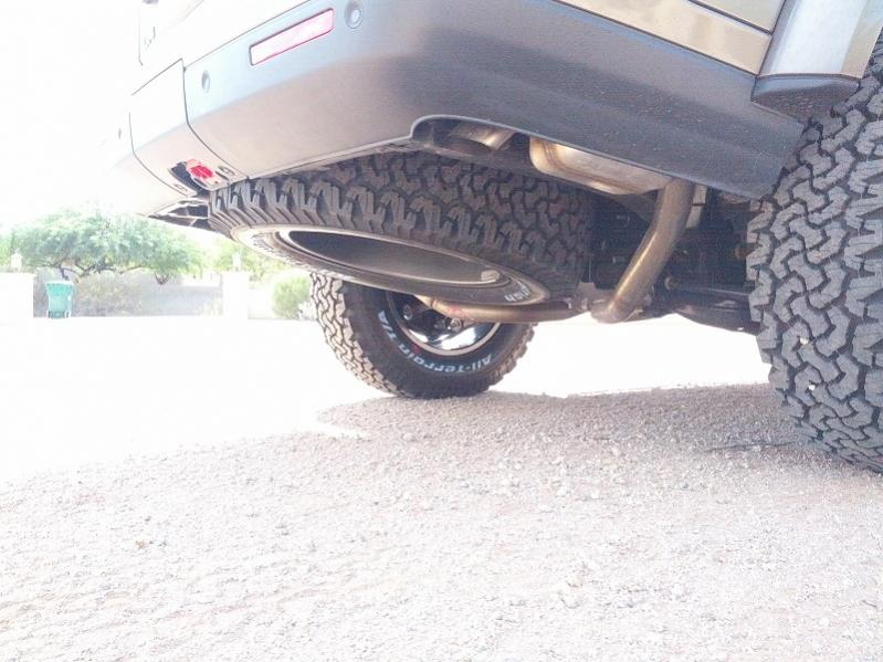

I am surprised you were able to fit a spare tire without removing a heat shield. I still have to kick my spare few times in order to get it all the way up. ( deflated to about 8 PSI). Make sure a spare is all the way up and in contact with a frame.
Post some pictures of your spare under your truck.

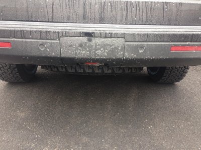

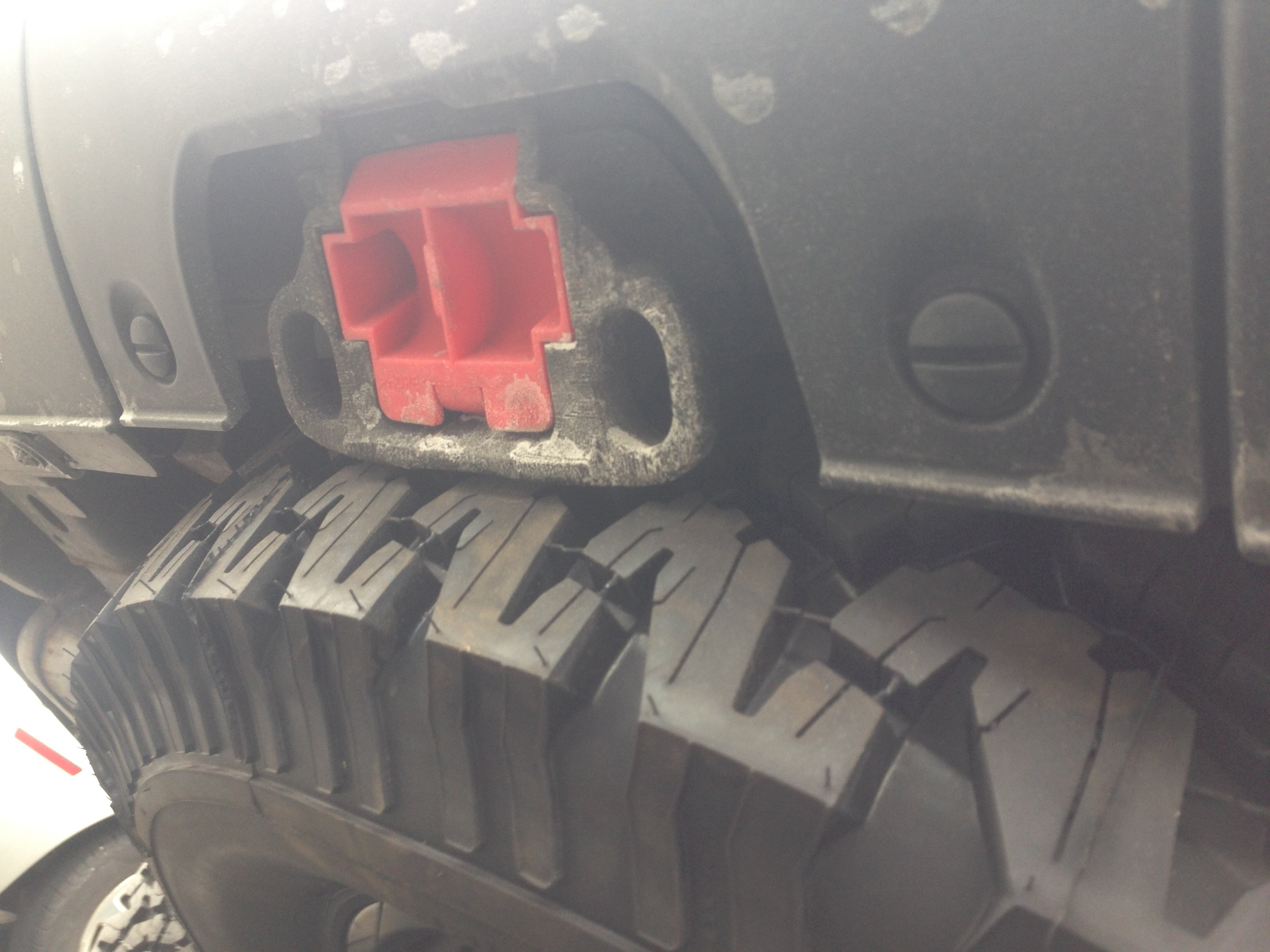

After a close look (sorry when the wheels/tires were installed it was late in evening and my wife has been driving since) it looks the spare tire may not be all the way up.

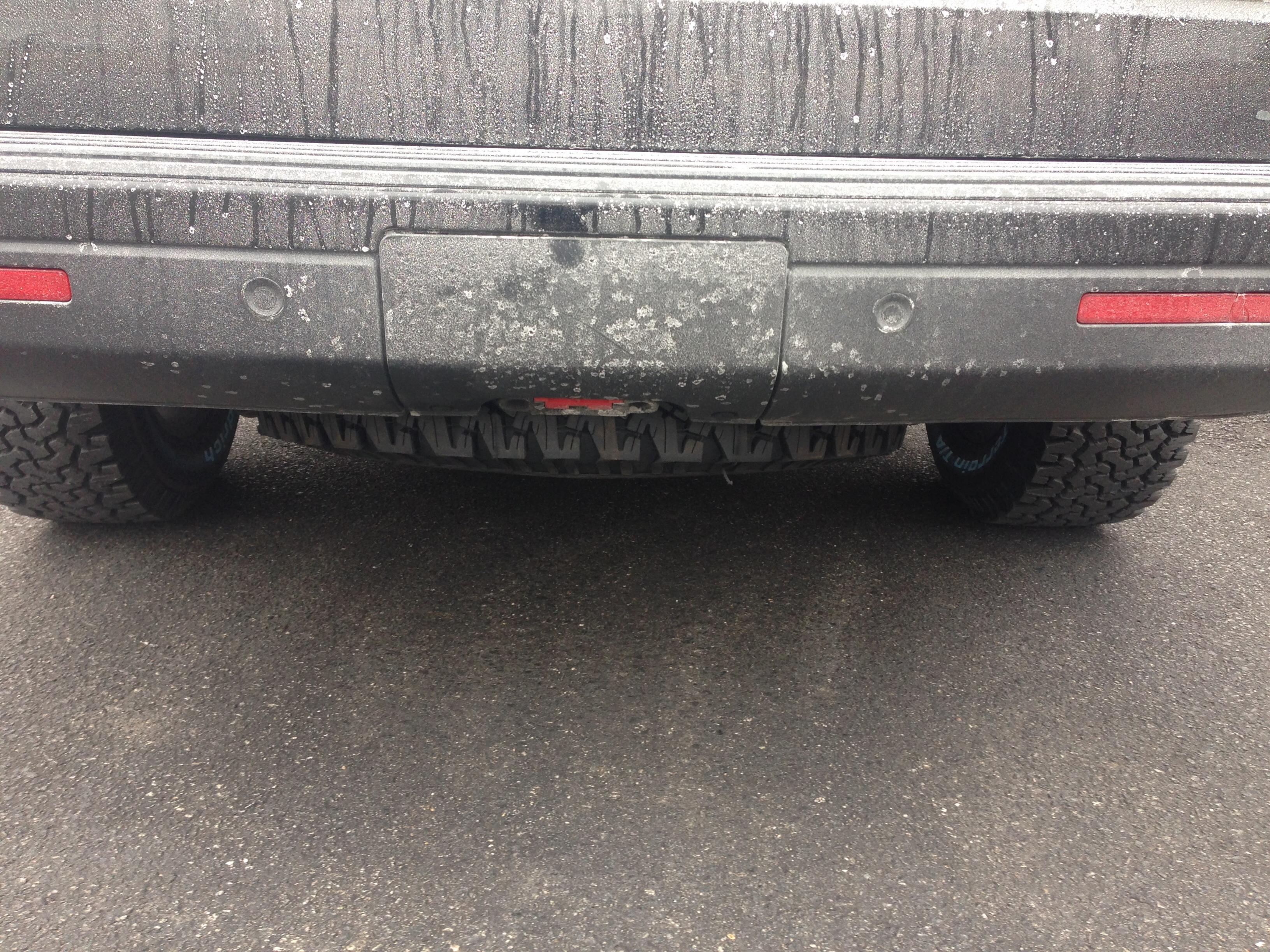

Here is another pic

it looks like the spare should go a little higher. I will find some pictures I took in the past and post them later. I am still amazed you were able to push it so far with heat shield in place. Is your wheel/ tire pushing on a heat shield??

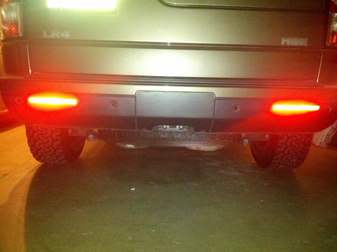

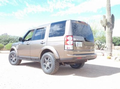

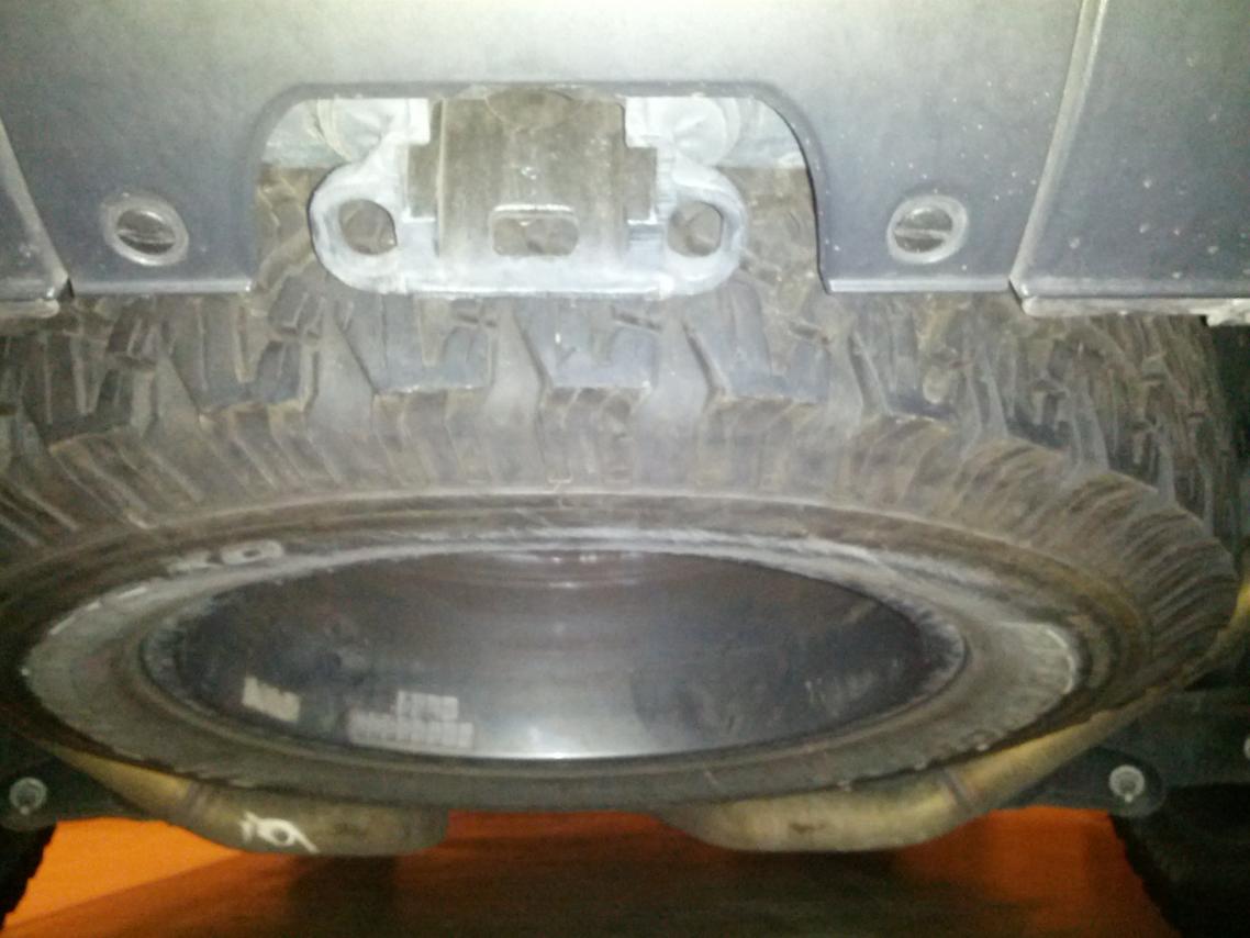

Here are the pictures.
