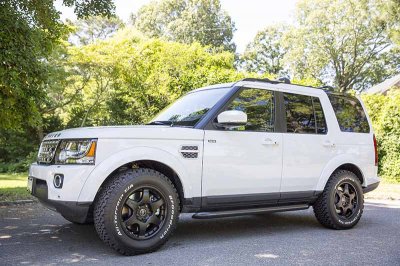

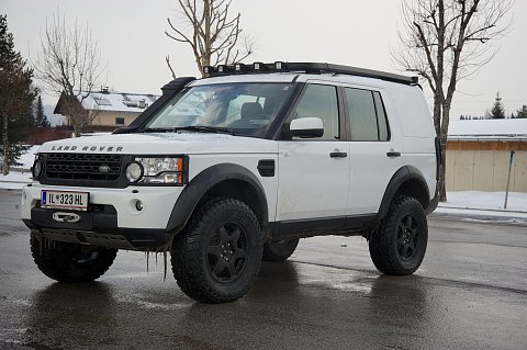

This combo rides better at 40PSI than the stock twenties on the street.
