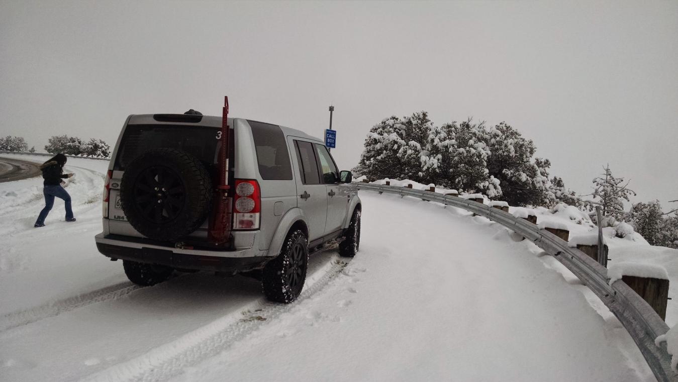

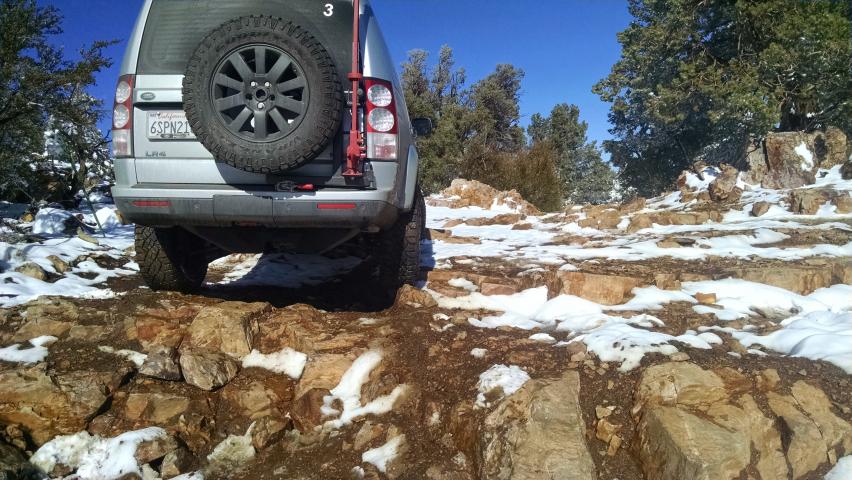

I run 265/65r18 Goodyear duratracks and love them. I also solve the spare tire problem. uploadfromtaptalk1426997125638.jpguploadfromtaptalk1426997222719.jpg
