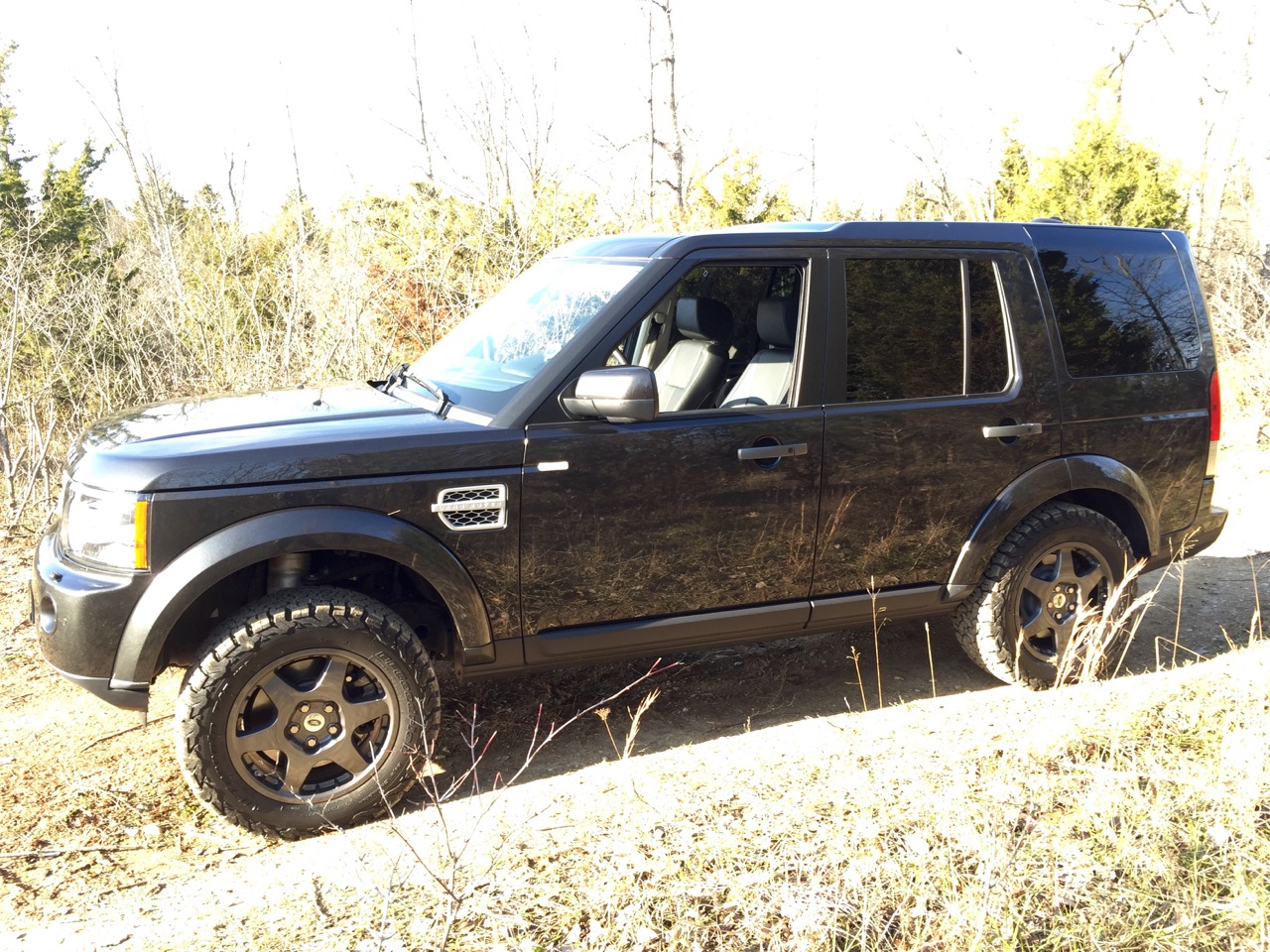

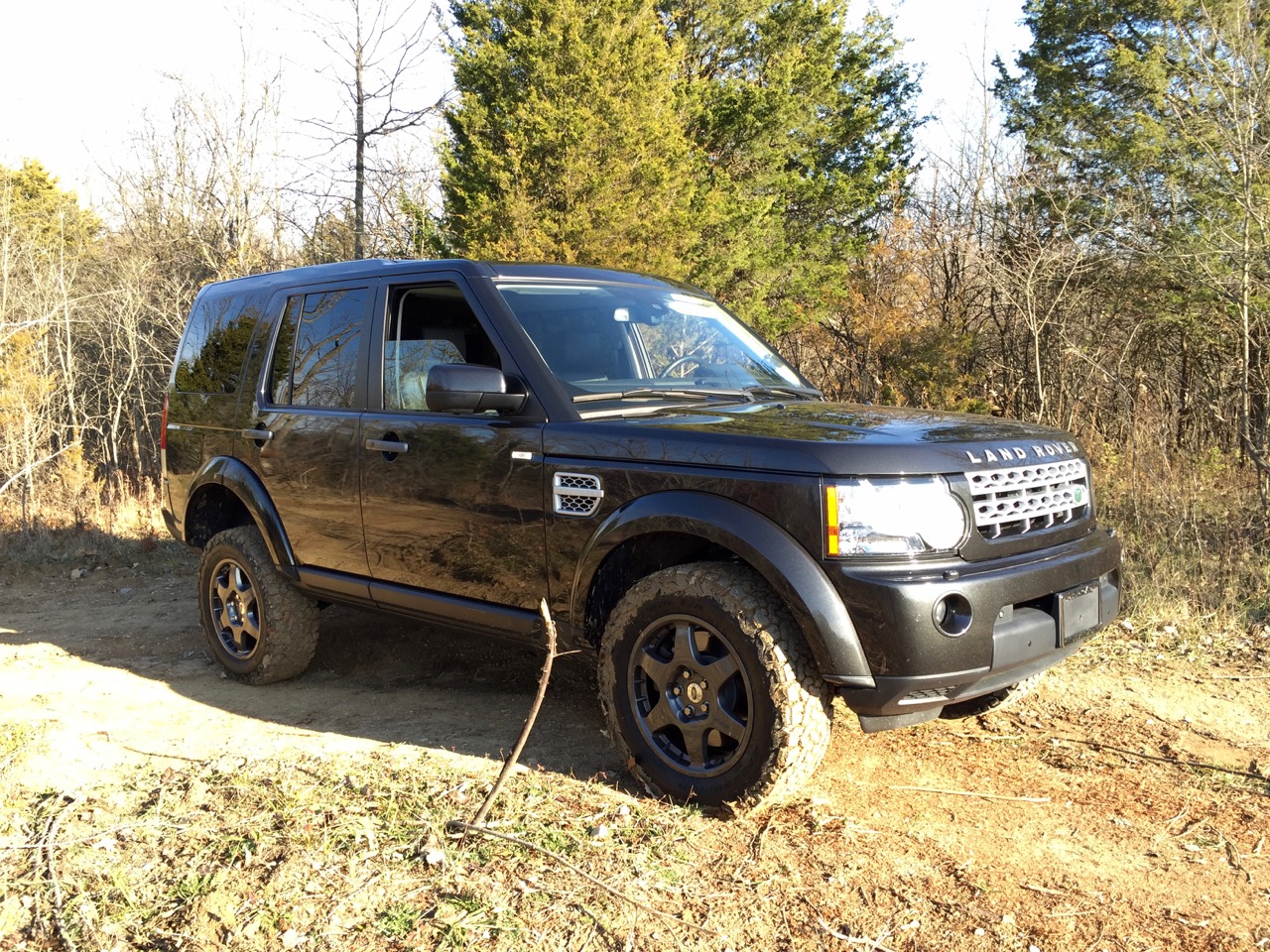

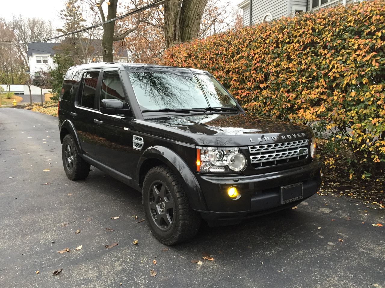

I installed my new Compo's and BFG KO2's in size 265/60R18 last week and love them so far. I started with them at 44psi front / 50psi rear which made for a jittery ride over broken pavement, so I lowered each value 2psi to 42/48 and the ride became much smoother. Amazing what difference such a small pressure change can make. I'm usually driving the truck by myself unloaded so I'm not worried about the lower pressure. I'll air up 2-4psi when towing or loaded up with my new VIAIR 300p (only $95 on amazon right now BTW).
Oh and I ended up having my tire shop install their TPMS sensors. $60/ea installed so I said why not. They used a special tool to read each of my existing sensors and then upload that program to the new sensors. No issues whatsoever so far.
A few photos. iPhone quality and a couple are overblown so the shadier areas were visible. It looks so much tougher now, love it.

Looks great! I love my KO2s as well and have been extremely happy with the performance in many different terrains.
As for the pressure, I have been working to find the sweet spot for a while. Due to the weight on my truck (roof rack with boxes), front and rear steel bumpers, and skid plates/sliders, I have found that 46 front / 50 rear seems to work well for me, but I am still evaluating those specs. I tried 46 and 48 all around, then did front/rear different, which seemed to work better.
Thanks for sharing!
