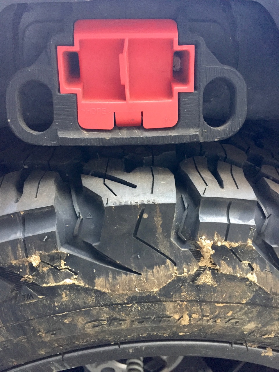

If you tow, the clearance behind the spare for the hitch receiver is a factor. Obviously many are making the 265/65's and 285/60's fit deflated, but here's how close mine is with a 1" smaller 265/60.
Do you also keep your heat shield attached?
