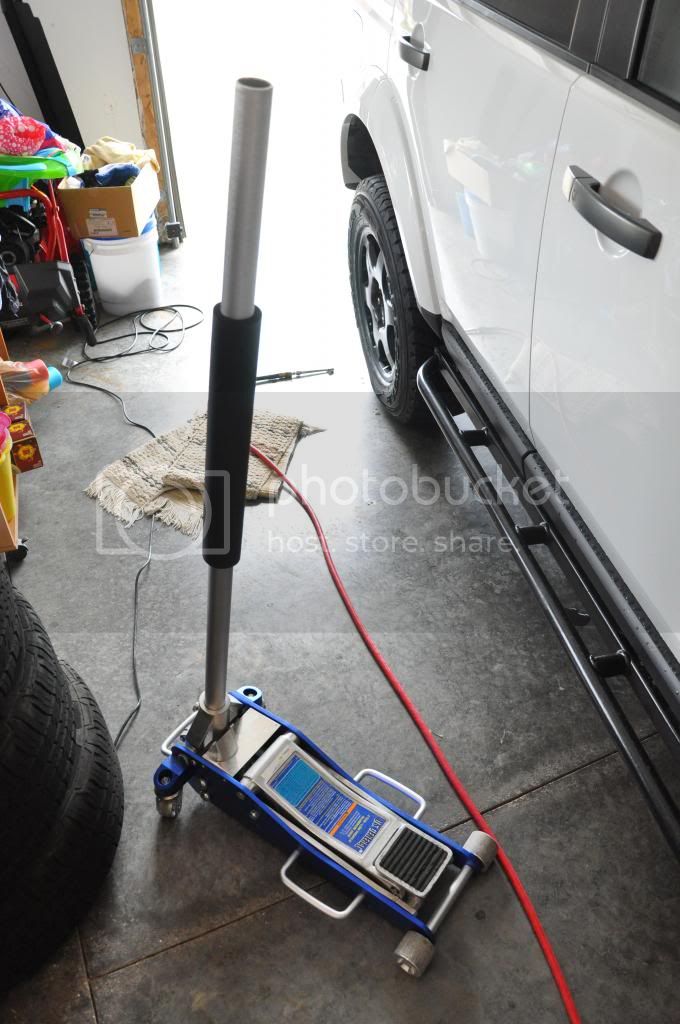

I don't have any specific brand to recommend but I'll share what I use to give you features to consider.
I have the heavy duty aluminum jack from craftsman, which makes maneuvering in tight places easier. It has a long handle to make pumping easy. It's also rated for 2.5 tons-ish so won't fail under the heavy LR4. The hydraulic pump doesn't lose air over time so if I need to leave my vehicles on the jack for longer I don't have to worry about finding my vehicle on the ground (I still use jack stands as a back up). Some jacks have built in pads to protect metal but I don't have that feature; I use an old poly spacer from an old Toyota spacer lift kit to get extra height and protect metal. I've seen similar pucks at the home stores.
I've been using the manual 1/2" torque wrench from craftsman for years; the model that's under $100. I wouldn't buy cheap at autozone or someplace like that unless your on a budget.

Get a half inch torque wrench. I have a craftsman, its rated for over 100 foot pounds. Also good to have a half inch breaker bar around in case bolts are stuck.
I have a light/aluminum jack also and its not tall enough for the crazy articulation on the LR4, i need to find something else. When I put my comps on I had to use the stupid scissor jack that came with the car.

I forgot to mention that I have Tactical Rovers T44 rock sliders with nerf bars installed.
I thought about 3 ton floor jack, something which will not break down after frequent usage.
With those rock sliders you can engage the floor jack almost anywhere so it is convenient.

That should be plenty of lift, even without the 3" extension thingie (21" and up should do the trick regardless of whether you run on stock wheels or oversized A/T tires.) Must be expensive and heavy as hell, but it looks like a really nice jack to have in your garage.
1,694
I dont know, i have a long arm jack and its not enough....
