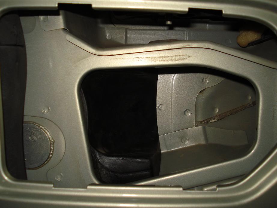

here it is with the foam in place.

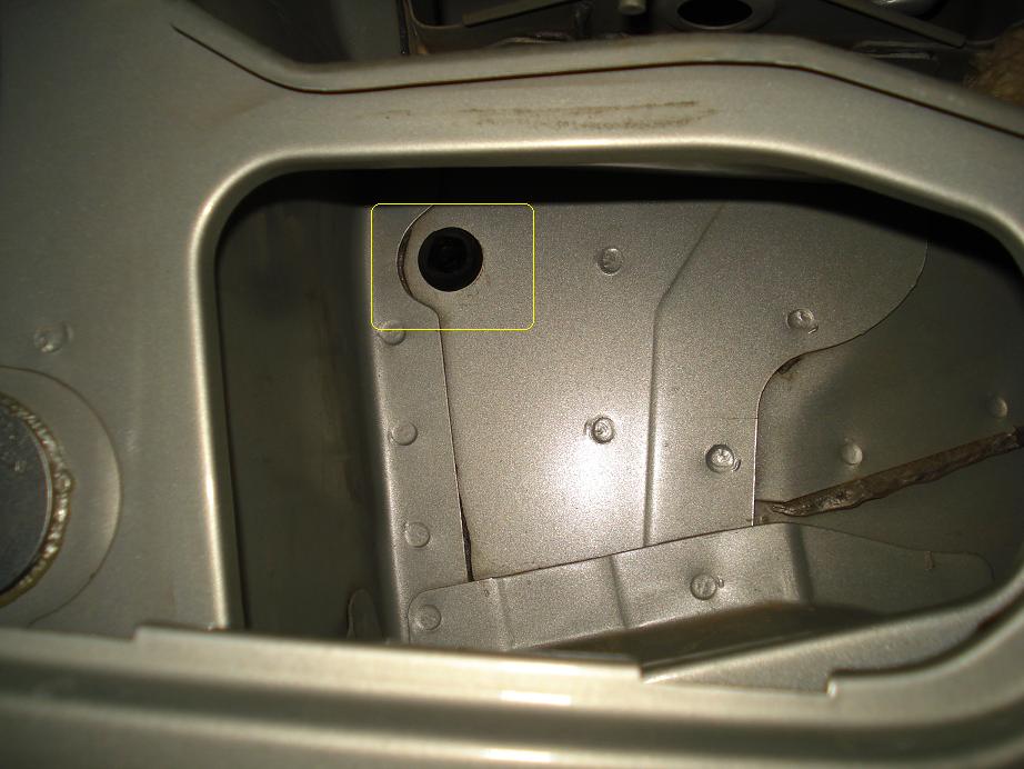

Here it is showing the drain already clipped.
Mine is an early 06
Sweet - thanks man. I had actually just figured that out - I was looking directly to the left when I should have been looking behind the rubber air inlet tube (in fact, I ended up pulling it out just like you did to get better access). I have some additional pics if it still isn't clear, but I think Trynian's photos sum it up well (the shot from a little further back is very helpful).
BTW - when I just clipped mine, you should have seen the nasty sludge that flowed out. Wow. Glad we got to this before our car interior got soaked!

Now the fun begins, there are 4 more to clip.
There is another one in exactly the same location on the driver side accept no vent for easy access. You have to take out the fender well and reach up into the same inner hole. Imagine the same location but there is no hole cut for the vent. You have to do it by feel. There is no foam to remove so you can feel it easy.
The there are 2 rear ones behind the fender wells of both rear tires. After the fender well is removed the drain will be torwards the front of the wheel well.

3 more, 4 total. All are easy to get to by removing the plastic wheel wells. The hardest is the driver side because you can't see it and have to do it by feel. If you envision it in the same location as the one you did it is not that hard to feel your way. The same inner openming exists, just not the outer opening where the vent grill is attached. No foam ruber insert there either.
