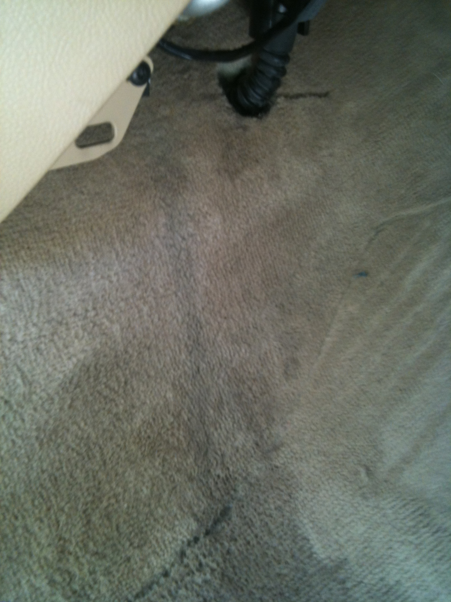

Both sides of the front floor mats were wet, the passenger much much more than the driver. I dried it out, left the rubber mats out. Next day I'm driving and I notice water coming from the center console under the dash, but I'm not exactly sure from where. See Pic. The carpet around the black rubber hose was wet, but none of the components above the carpet was wet/moist. If I pull gently on the black hose, water will start coming out at the connection. What is this hose for? Is the hose unrelated to my problem? It is July in So. Cal., i.e. no rain, but I did take it to a car wash about 3 weeks ago. So why am I still getting water?

Thanks for the picks/link. The black rubber hoses are the AC drain tubes.
It was odd, though, while driving around, I had additional water come in from under the radio stack, but NOT immediately adjacent to the drain tube. Confused, I went to the dealer.
Props to the service rep at the dealer: it was the end of the day, he was convinced it still had to be clogged AC drains, and had the service tech prop the car up on a lift. From under the car, they put a wire (?) through the drains and my car promptly ****** all over the floor. No charge, no more water coming into the car.
I asked the tech if I can access it from inside the car and blow air or feed a wire that way. He recommended 'no' for the following reasons:
1. separating the tube from inside the car could dump loads of backed up water into the car
2. if it is really, really clogged, blowing pressurized air my cause the rubber hose to disconnect from the other end, dumping water in the wrong place, and I may not be able to easily reconnect the hose
3. feeding a wire thought the soft rubber hose may inadvertently puncture the hose, causing additional leakage
They recommend ONLY clearing it from under the car...
