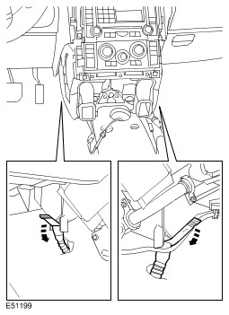

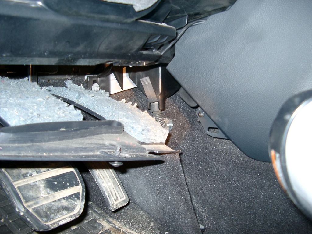

Air Conditioner Water maybe?
I presume that your carpets are wet after it rains? If not, then the water can be coming from the air conditioner drains that have disconnected themselves.
I had really wet carpet near my gas pedal, but dry near the door etc. It turn out that the condensed water from the air conditioner drains out of the heater box on both the left and right side of the transmission ****.
There are two rectangular hoses, one on each side of the transmission **** that connect to drains on the bottom of the front heater box and then pass down thru the metal floor. Rarely do you see water drips under your 3 as the water flows onto one of the skid pans below and evaporates there. If you have the rear AC/heater, the water drips onto a heat shield above the rear left side muffler and evaporates - hence you rarely see AC water dripping from your 3.
Re the front heater, the rectangular rubber hose just slide down and off the heater box drains. All one has to do is access them and slide them back up. The jpg shows where to unclip the piece of vertical carpet that is just to the left and right of the radio stack..
The links below show a picture of one of the hoses and also a Land Rover drawing.
