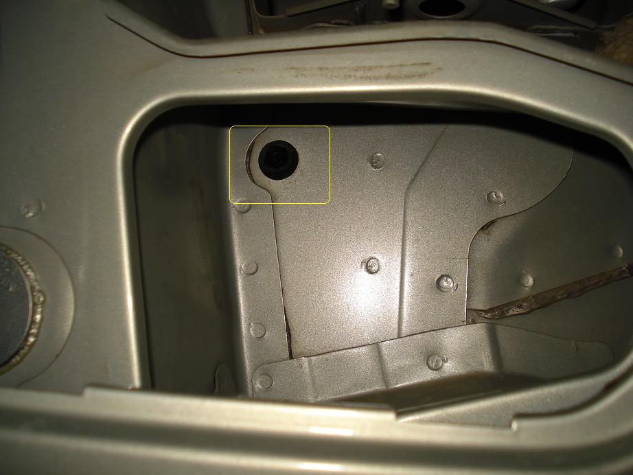

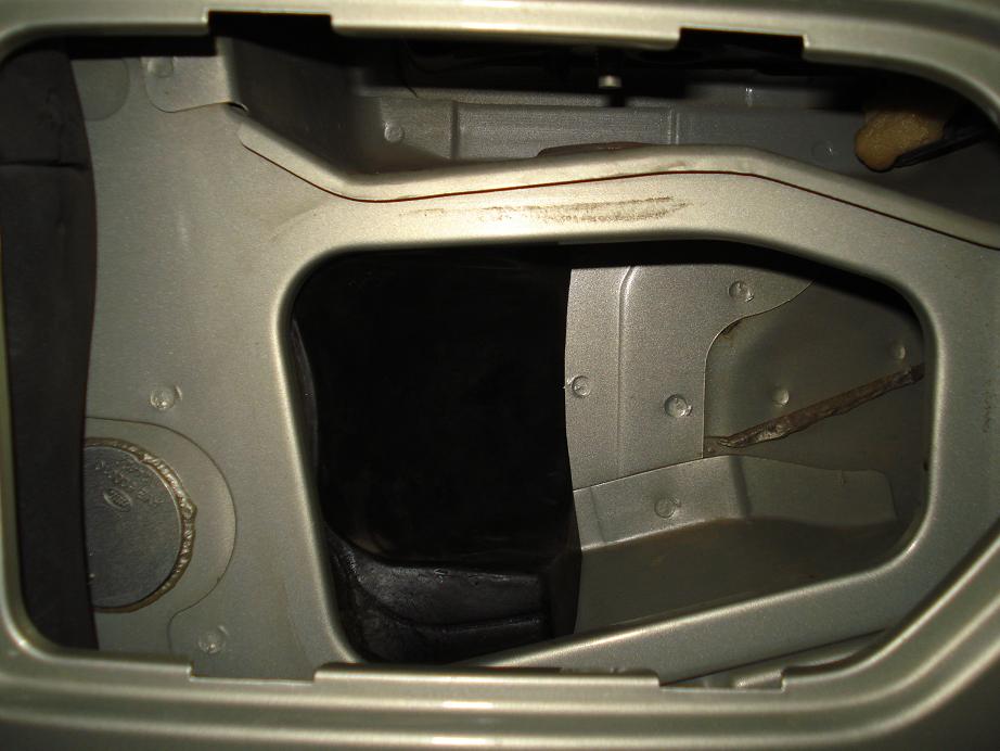

here it is with the foam in place.
Here it is showing the drain already clipped.
Mine is an early 06
Trynian
Do you happen to have any pix of the "other" drains by chance or maybe even a map or something cuz MAN ALIVE I cant even figure how u found em in the 1st place.
Ive taken mine to the NB dealer and its mostly "NO BUENO" instead cuz they say uncloged reroute/replace but keeps happening... maybe they need to do the rear also.
Pull the rear wheel well covers out and you cant miss them, they are toward the front of the well.
The other front one is in exactly the same spot as the one behind the vent just with no outer ven hole. Pull the wheel well and feel for it. After you clip the ****** run some water through the hole in the top drain holes in the sun roof.
