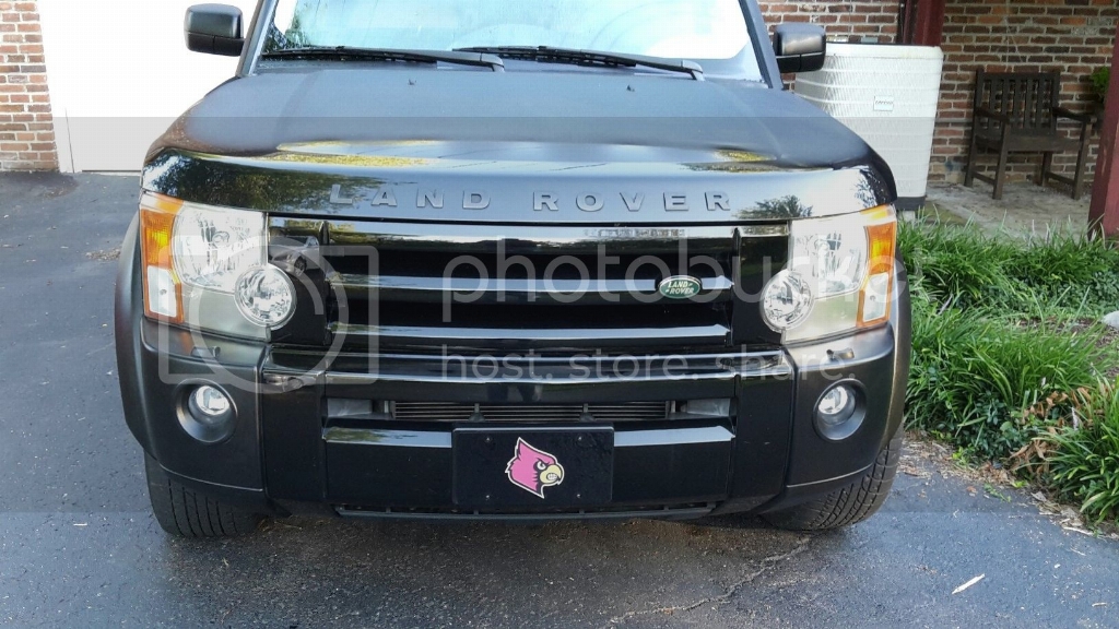

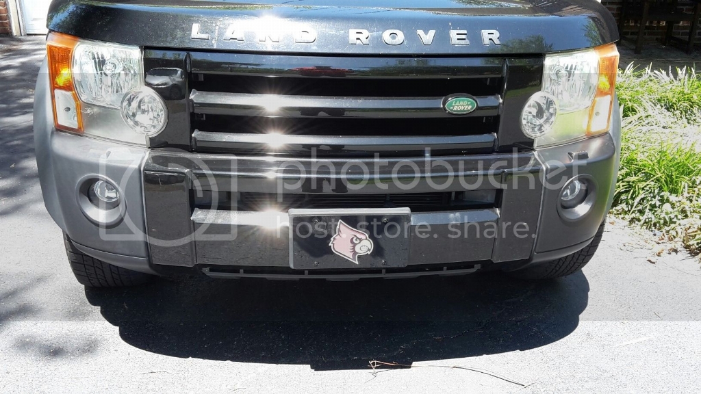

I know we all like to keep our LR's looking spiffy. Of course the first thing to start looking a little gray is the plastic trim and fender flares. I used KIWI black liquid shoe polish on a couple of Volvo's that I used to own and it really did a good job of bringing the black back to life. I found it lasts a fairly long time and is easy to touch up if needed. It's also a very inexpensive way to deal with the fading. I just started this on my LR3 and thought I would post a picture showing the difference. I'll post some more as I get it done. In this picture the drivers side corner trim is the only part that's been done.

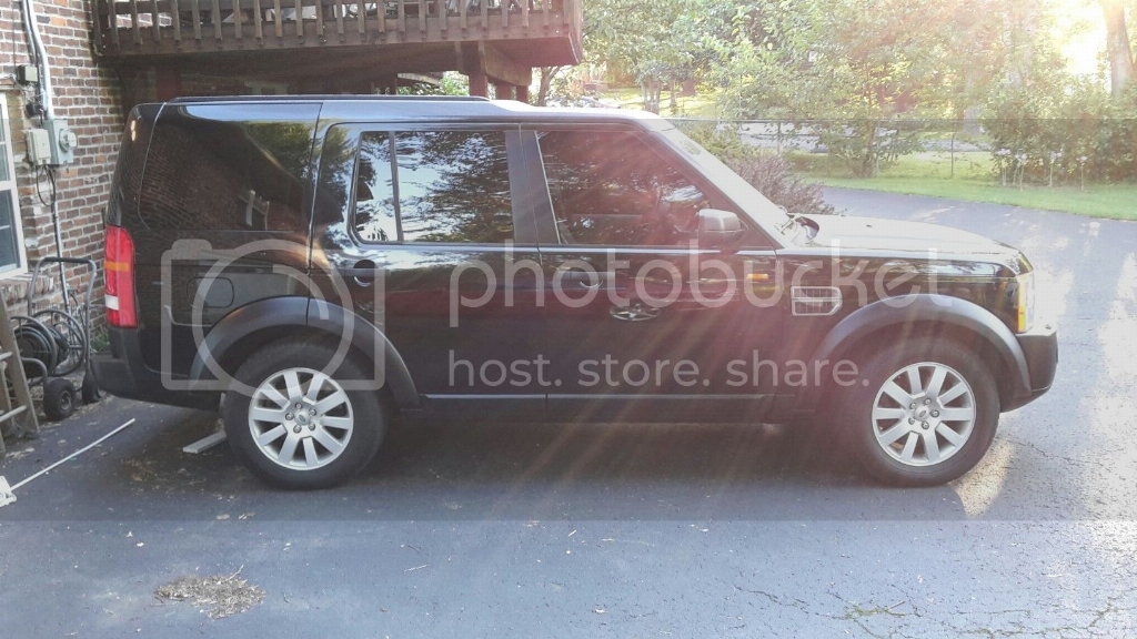

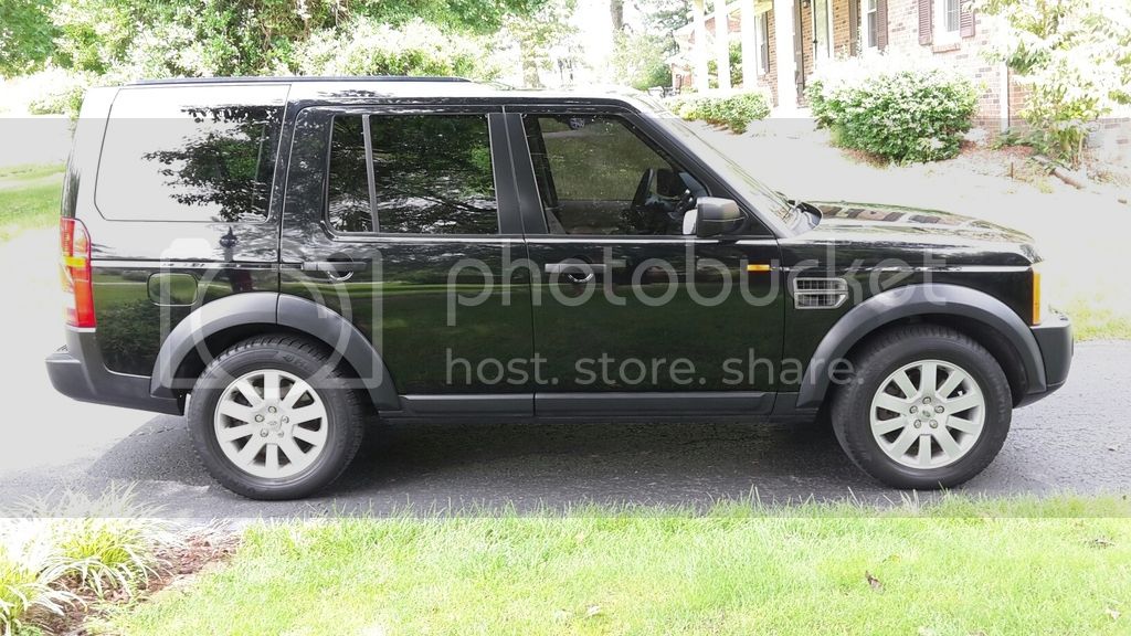

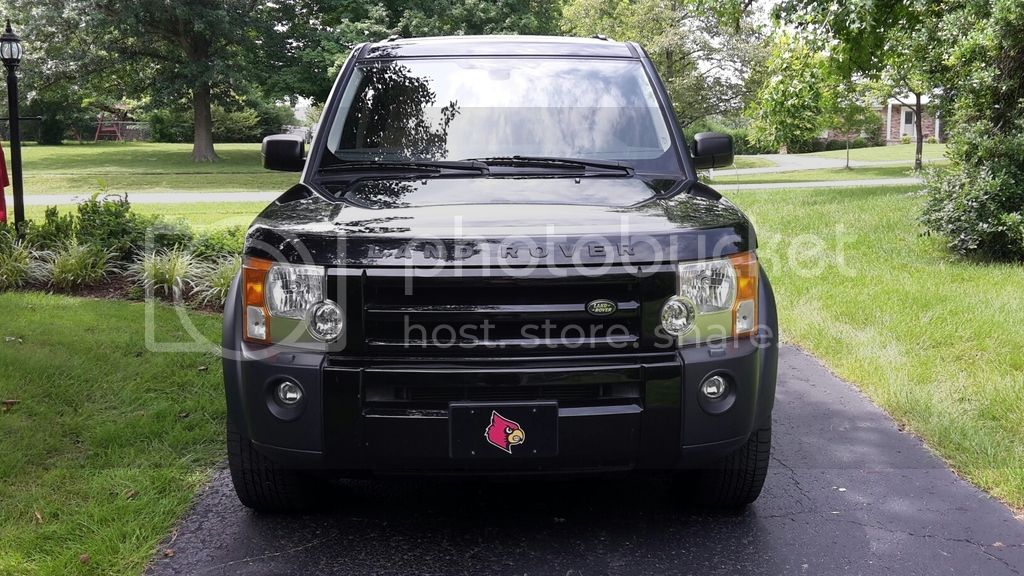

Nice weather last night so I was able to get all the plastic pieces coated. Probably do a little touch up after a day or two but here's the before and after:
Morning sun making it a bit hard to see the difference but it is significantly darker.
