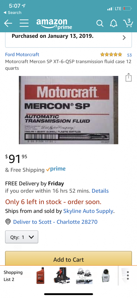

I bought the Mercron SP for $80ish 12qts and it smells the same but is red (same color as dr tranny’s instant shudder fix which is interesting). It is red in color. Ford markings all over it. Will send a picture over later today. This thread is way off course though ;-). We stareded out discussing vacuum pump...

You’ll be safe with 10 quarts total. Mine took just over 9 quarts of the stuff above
“St-6-qsp” should be the specs to look for if someone chooses to go with the Mercron SP
