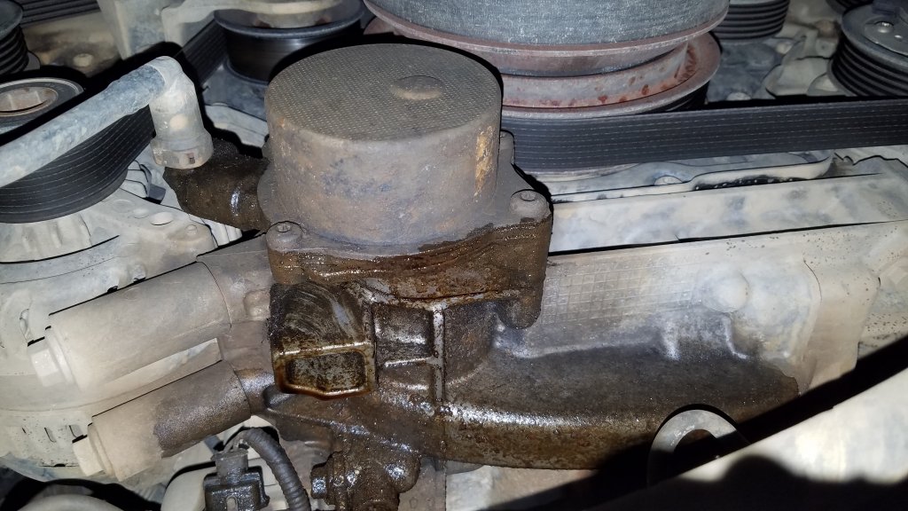

Sorry should have done a little more digging before posting. That part is the vacuum pump. I’m pretty sure that’s the cause of the leak, has anyone ever replaced one before? Any help is greatly appreciated.
Before you change that vacuum pump, tighten the bolts a little bit and clean around it with brake cleaner. After driving for a few days check to see if the leak has stopped. i have had plenty of success over the years by just slightly tightening parts that are leaking.
Agreed, my dealership is a big fan of tightening stuff to fix leaks.. My transmission cooler lines aren't leaking after the LR tech gave them a good twist.. Torque specs?! We don't need no stinkin' torque specs!:biggrin:
Yeah good idea, I’ll give it a try. After watching a video on the timing chain guid replacement, from what I could tell you need to drain the oil when you remove vaccine pump

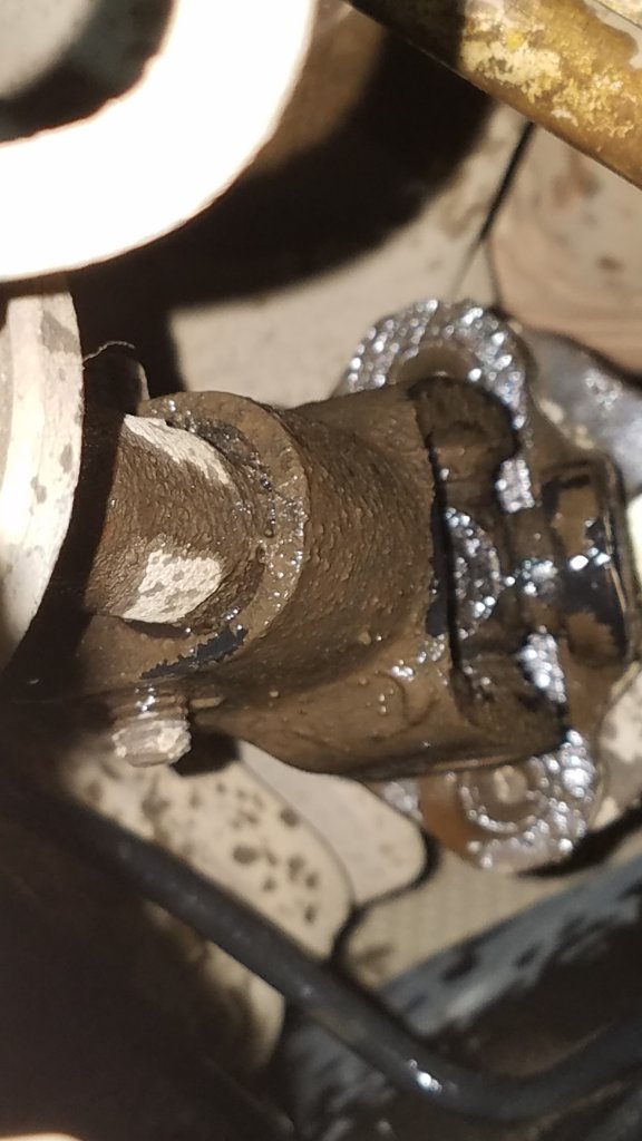

Well, what do you FK-ing know. Look what I discovered when trying to trouble shoot my steering issue. I must have jinxed myself looking at this thread. On another note IE steering issue the prob appears to be the steering shaft because half a can of WD-40 has fixed the notchy issue temporarily:
