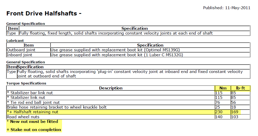

I thought they were torqued to 230Nm / 179lb.ft?
or am I having a brain fart?

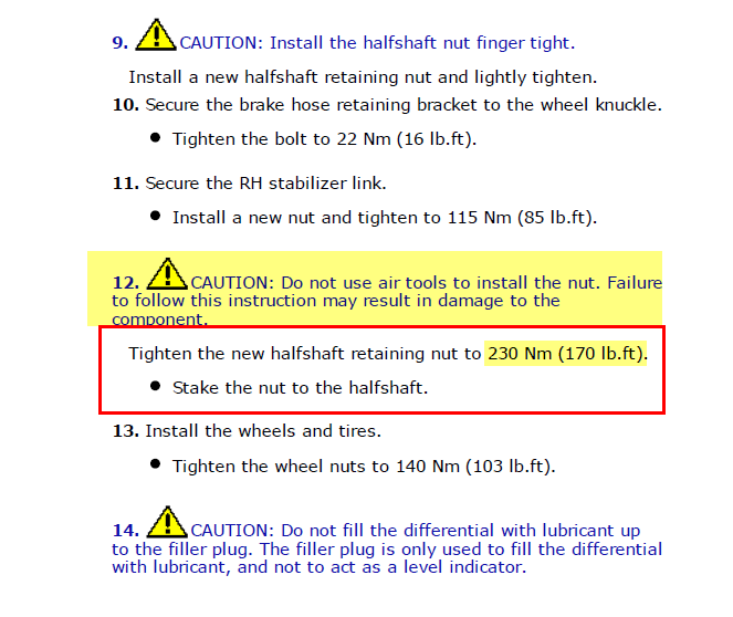

Looks like you are correct, FSM screenshot below. Don't know where OP got the 268 lb-ft (363 Nm) data.
Same question though, I would assume you put the truck on the ground and then tighten. No need to do it in the air, unless the tools will not fit through the center hole of the wheel (I haven't checked)... that could be the issue here.
The FSM also says not to use air tools (i.e., impact wrench, including electric impact); I assume to avoid over-torquing.
