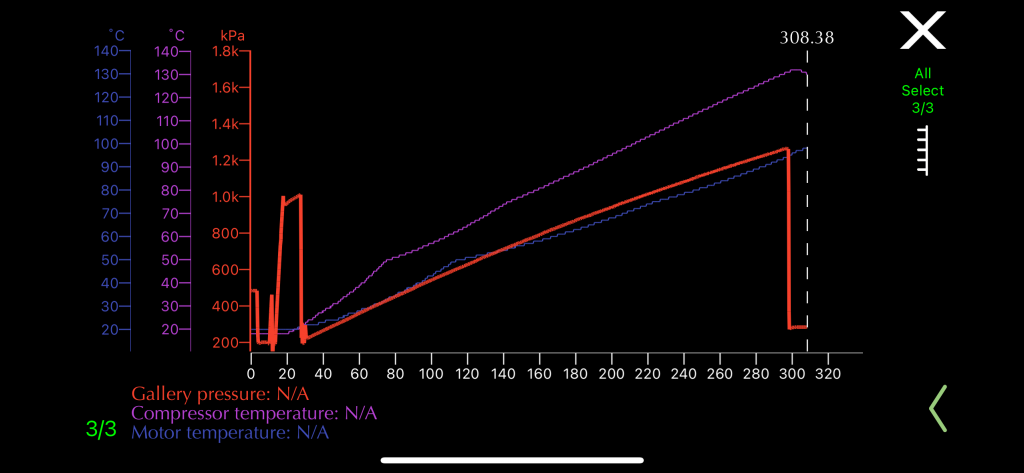

I installed the new compressor on Sunday and logged the reservoir being filled again. I also have a log of the old compressor doing the same, though I didn't log the full fill of the reservoir, only up to the first thermal cutoff.
Old:
New:
I haven't had a chance to log a normal to off-road height change.

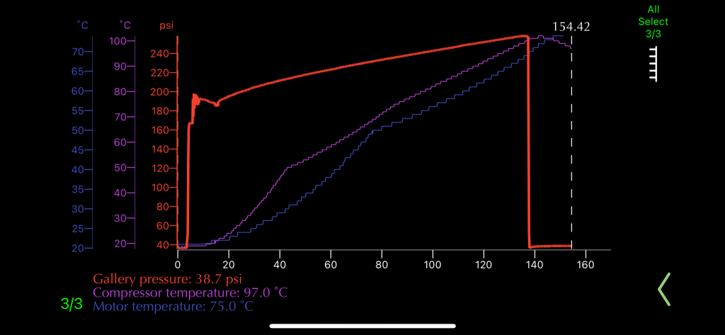

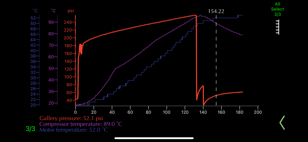

I logged the change to off-road height with the new compressor. For reference here's the old:
And with the new compressor:
Doesn't look all that different.

The second pic in post #11 looks suspect as if its losing air or power.
ftillier
Jul 27, 2021
944
514
Portland, OR, USA
That's temperature shutdown, when the compressor reaches 130*C, it then waits for temps to drop back to 110*C and starts up again. It does look like there's a pressure drop from when it shuts down to when it starts up, but that could be due to temperature change too due to the air cooling and becoming denser.
