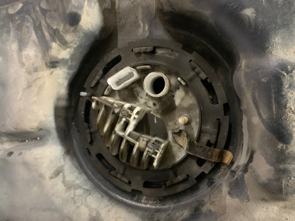

Ok folks. Got the job done at my local Indy. 23DBB6B0-94D5-429D-B59E-29E0B871CE6C.jpeg same problem as others here. The parts are very cheap online. Like $60 for non oem. But I had a rental and couldn’t get them fast enough so I had to go the stealer. $250 out the door with tax. Ouch. Easy repair though. $200 in labor. Parts guy said these fail all the time across the platform. Great. Back to normal now.
My wife is starting to Moan about the reliability here.

Ok folks. Got the job done at my local Indy. View attachment 11568 same problem as others here. The parts are very cheap online. Like $60 for non oem. But I had a rental and couldn’t get them fast enough so I had to go the stealer. $250 out the door with tax. Ouch. Easy repair though. $200 in labor. Parts guy said these fail all the time across the platform. Great. Back to normal now.
Is the Flange the same as the part described above as Part Number LR043420?
Pretty sure that’s it. Google it and find the cheapest one. Fcp has one for way less than dealer
