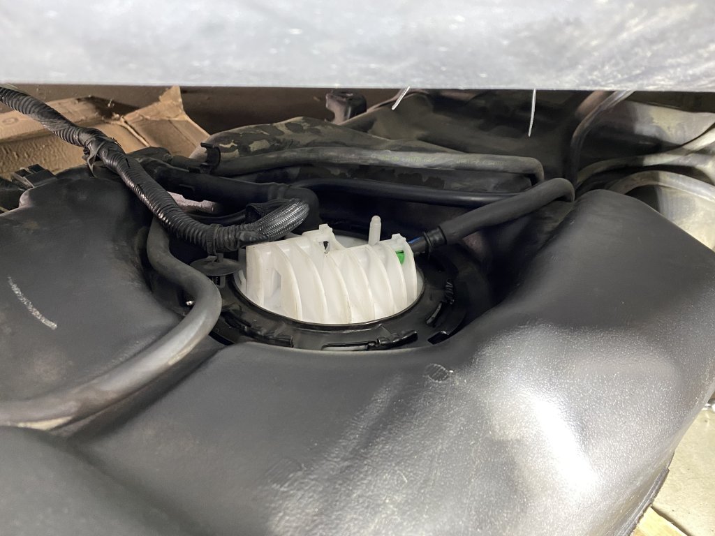

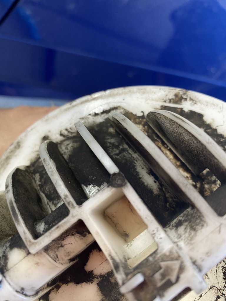

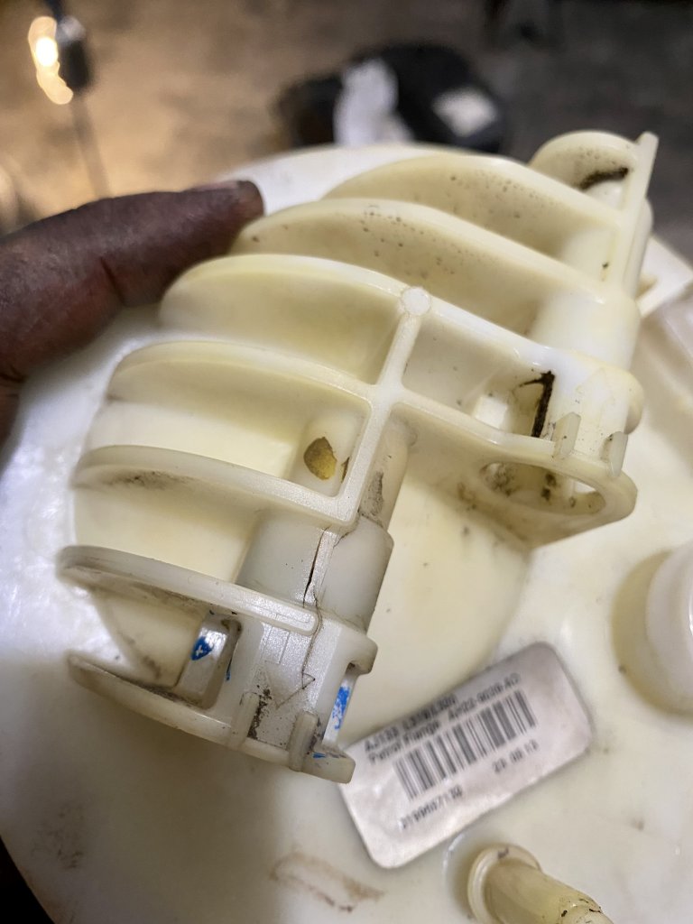

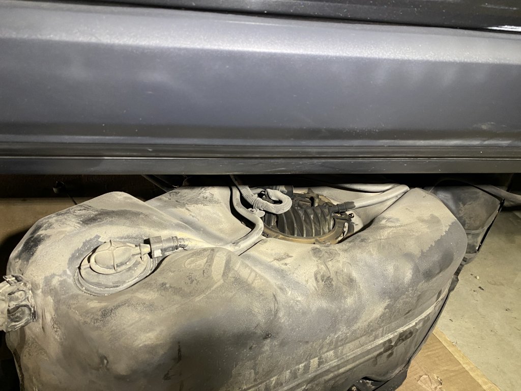

Just ordered this, haven’t inspected anything but I am getting a distinct smell of fuel. The gasket was $10 and the cover piece was $50 from rock auto. That should be it? I’ll drop the tank in the garage, not looking forward to it but not anything I haven’t done before.

Just wanted to update, my truck looks like it has the “updated” design, but still failed. If I have to do it again, I want to do it on a lift or a bigger garage, but it’s an easy job.

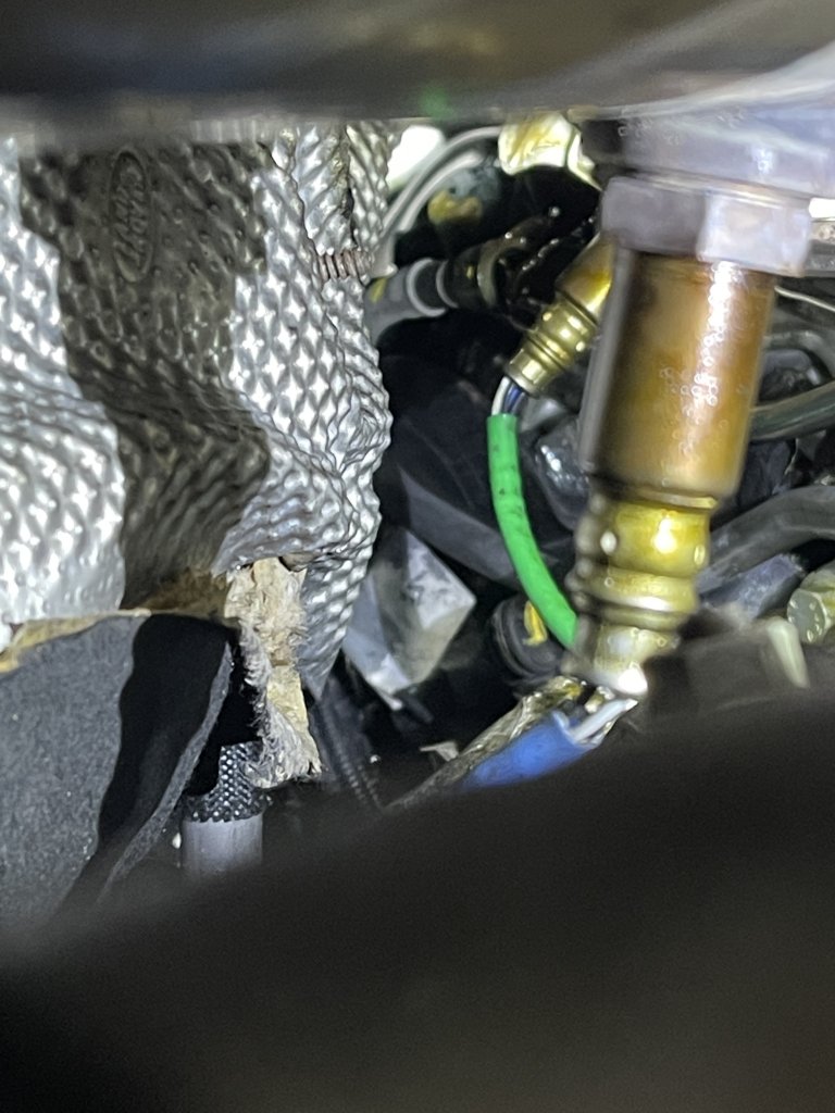

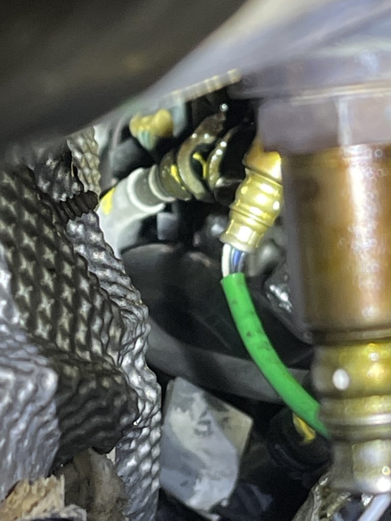

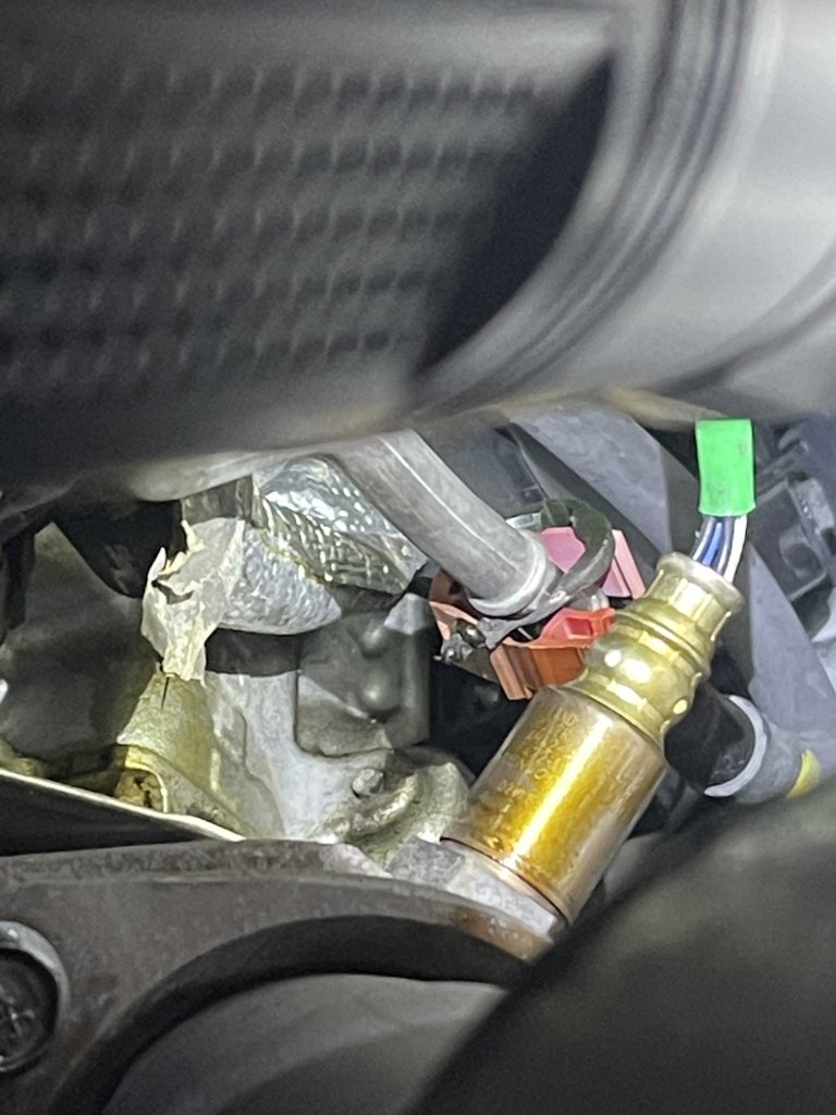

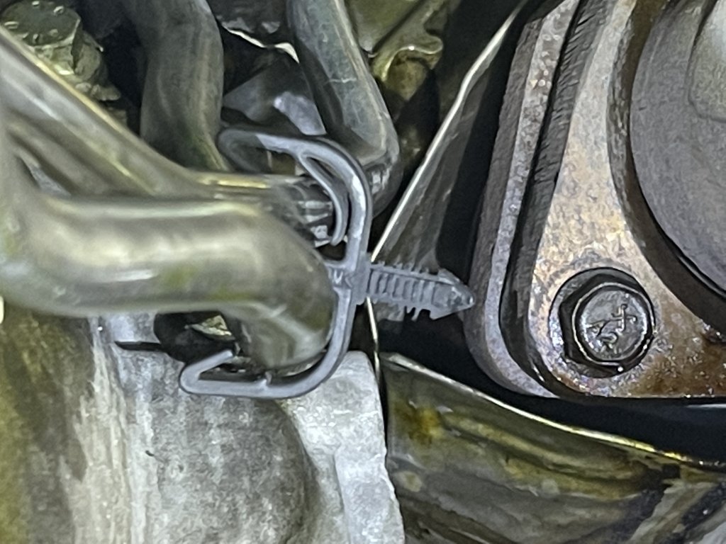

I had a similar issue. I would smell gas also only outside. Finally found that the fuel rail connection was melted. Apparently the fuel rail and the transmission hose share a clip together because both are right by the exhaust under the car right around where the gear shifter is inside then under that outside under the truck. I was also getting a gearfault. I had to replace the rail hose and put the clips holding the fuel and trans hose together away from the exhaust. Before fuel was actually leaking right on the exhaust that is right in the area . The red Clío had melted since the clip holding both hoses was not properly installed See pictures

That’s seriously clean there Louis. Glad you caught this before it went up. I’ll check mine this week. Thanks for putting this one out there.
