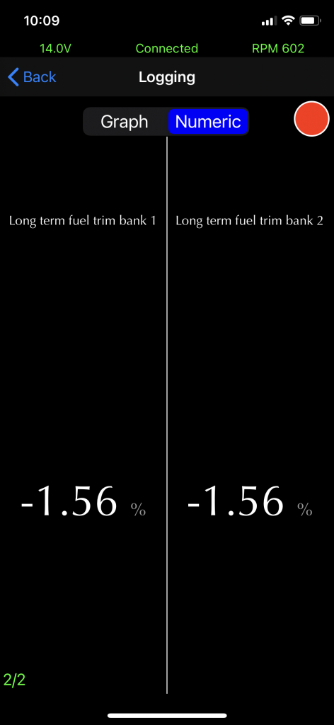

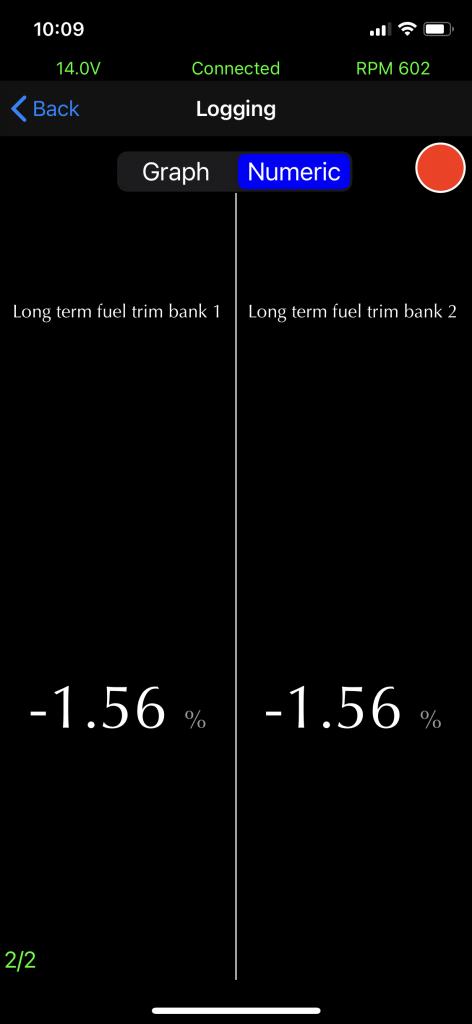

Here it is.

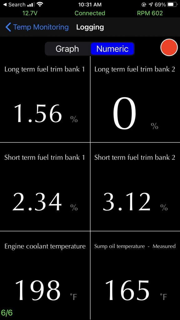

You're running lean, brother. LTFTs look good, but STFTs could improve. May just be a dirty filter, or the AIT sensor on the MAF may be dirty and the changing weather is throwing the ratio off
Isn’t a positive % a richer mixture? I for the most part don’t think I have anything to worry about with my fuel trims. I’m just surprised it’s close to 0. The ambient temp has been 100-105 every day recently.
