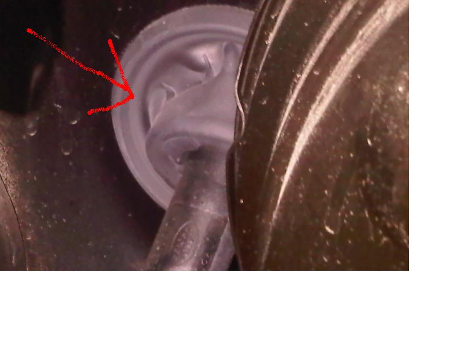

nwoods -
THe hard way is in the wiring loom grommet above the dead pedal (to the left of the brake pedal). On the engine bay side, this is under the master brake cylinder. The easy way is through the grommet for the steering column.
Is the picture below the grommet you are talking about? Can I run the fog light wires through this section? Let me know, thanks:smile:

nwoods
Apr 27, 2006
1,675
Yes, that's it exactly. Poke as small a hole as possible, then seal it afterward's with black silicone. Be sure the wire is as far from the steering column as possible, and routed in such as way as to not foul it it.
