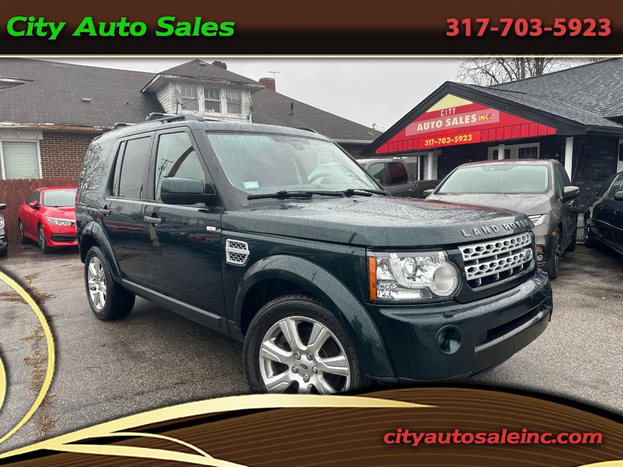

What do you think of this rig ? And its price ? It’s a rebuilt title.
