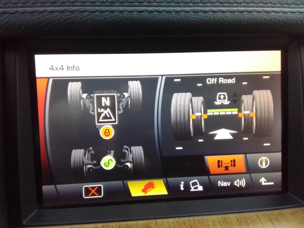

New to me, 2011 LR4 HSE w/ full-sized spare. I've read that means it has the HD package. I suppose a person could have upgraded the spare on a non-HD. I remember reading a post about a wire going to the rear axle (locking). For my limited purposes (camping, upland bird hunting, snowy roads, etc.) it sounds like I would be fine either way. Still, now I'm curious. I'd be willing to take a pic of the axle and share it if someone could point me in the right direction as to where to look for the wire.
I sat in a level parking lot next to where I live and played around with the terrains selector a bit. There was a diagram of the undercarriage showing open locks on the center and rear when I set the selector to low and rock crawl. I thought that must have meant that I didn't have a locking rear diff. After doing further reading, it may be the case that neither the center or rear are going to show as "locked" unless driving conditions call for them to lock. If that's the case, I'm still unsure what I've got. At this point, the only thing I can tell for sure is it has a full-sized spare.

If you go to the 4x4 info screen, and see two differentials you have the rear locker.
Put it into sport mode, steering wheel straight, and floor it and the rear locker will partially lock up.

You mean like this then?

It appears you have the HD package. Consider yourself extremely fortunate. I'm guessing only around 1 in 15 LR4s have it, and a lot of people will scour the earth to find one when they are buying.

Thanks ryanjl and hickersb. Special thanks to RR who was able to look up the detailed info for me on my rig. Turns out I don't have the HD package, just the display. I'm a little disappointed, but it allows me to keep my truck (I would have been seriously tempted to sell it). Plus, I'm not going to upset folks that would hate me for being a novice that lucked into something they really want and could use.

I was actually thinking uphill. Mine (HD) definitely locks when goosing it pointing uphill... but if you don't have the HD package, I don't think the rear icon is ever going to change from green (unlocked) to orange (locked).

Regarding the display, I may have figured out another way to tell if a diff is locking, or open. Notice the vehicle is in neutral. No way the locker is going to engage while the transmission isn't engaged. It isn't even moving. There is no slippage for the computer to interpret. My sense is this display diagram is showing the build capacity of the rig (center locking diff and rear unlocked "open" diff).
The image is taken with the vehicle in Rock Crawl, low-range, and raised.
