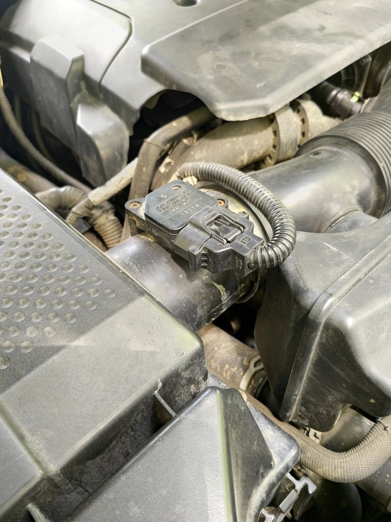

Thank you so much for your posts everyone. I am a newbie and late to this form by a decade or so, but if anyone else is experiencing these multi-fault code issues, I want to post my issue. I had a loose connection at the connector adjacent to the front of the battery/fuse box cover. The wire bundle seems to be under a bit of tension and prior owner must have disconnected for some reason and never "clicked" it all the way back together. So, check this connection in your diagnostic search. I had already replaced the brake light stop switch and some tail light bulbs and checked the battery voltage (just fine). Happened to notice this connector and while checking its connection noticed that it clicked when I pushed it. Tada... problem resolved. Pray everyone else's issues are similarly simple to resolve.

The above two posts are certainly appreciated. #41 says the "replacing the brake light switch was the solution" and #42 provided another solution to the problem - something I had not heard of prior, hence I learned something.
