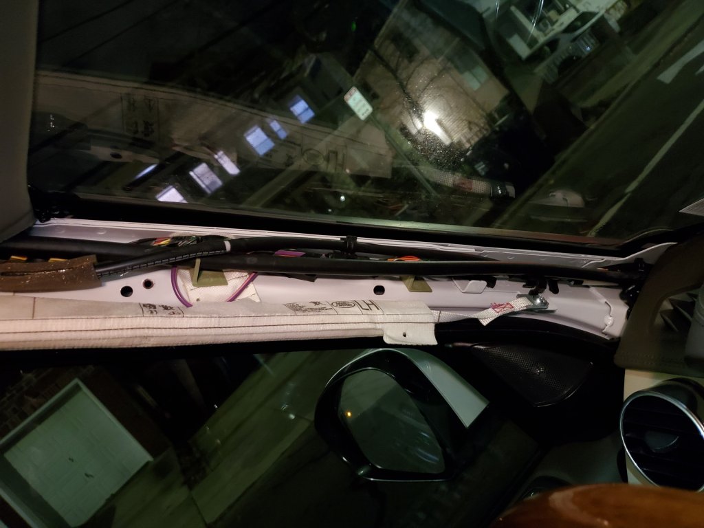

You have to remove plastic "airbag" labeled bit, remove torx sxrew, remove trim and connectors are there, on both sides.
My windshield heater cables were NOT connected when the windshield was replaced. I had to connect it myself. I don't know why these windshield guys are forgetting about those connectors :/

So it turns out the issue was the the passenger side connections, just as some of you have pointed out. They were plugged in but not maintaining contact. After unplugging and plugging back in and checking for continuity, it works! Also, the windshield warms up enough to be able to feel it on your palm.
