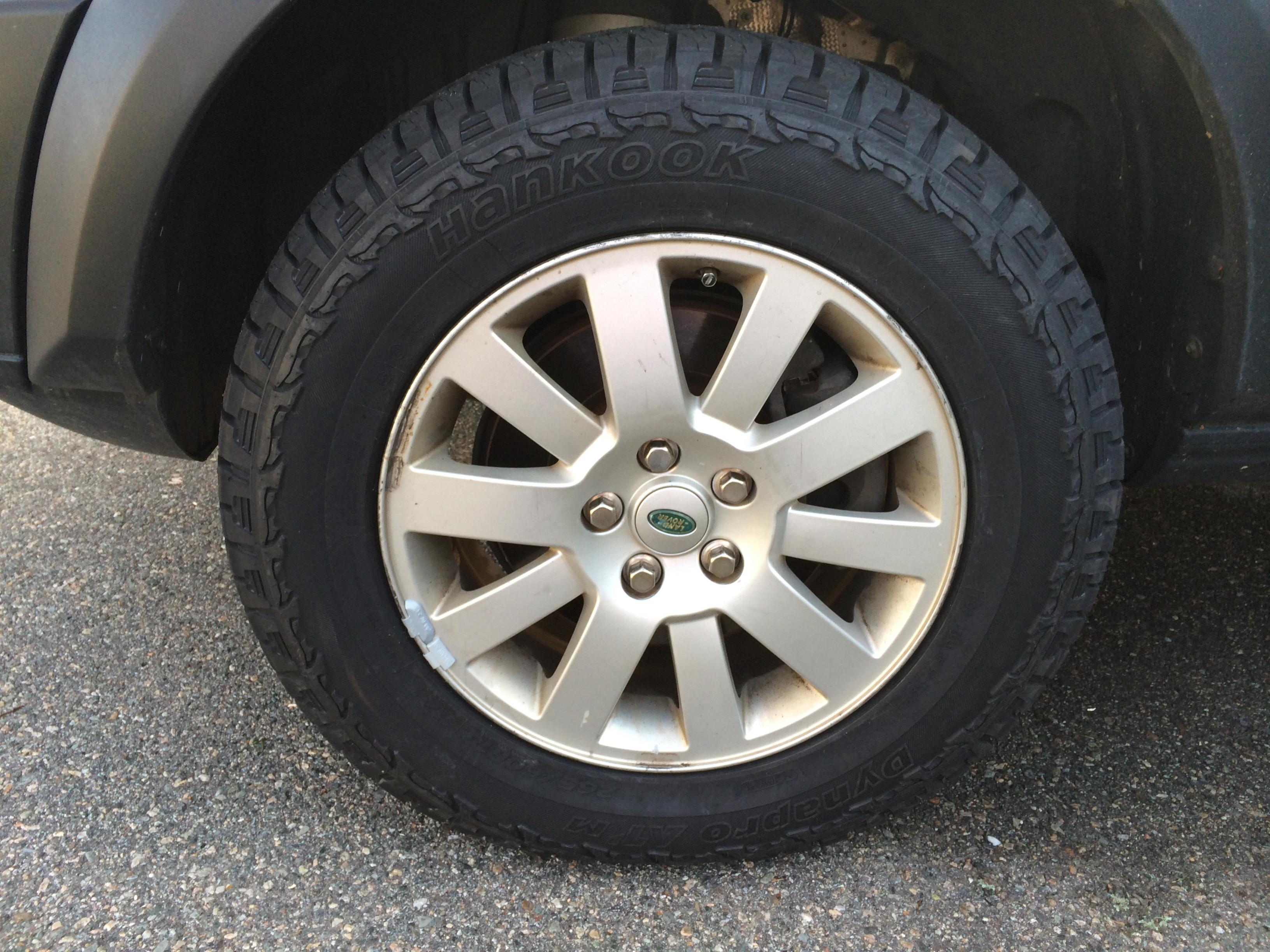

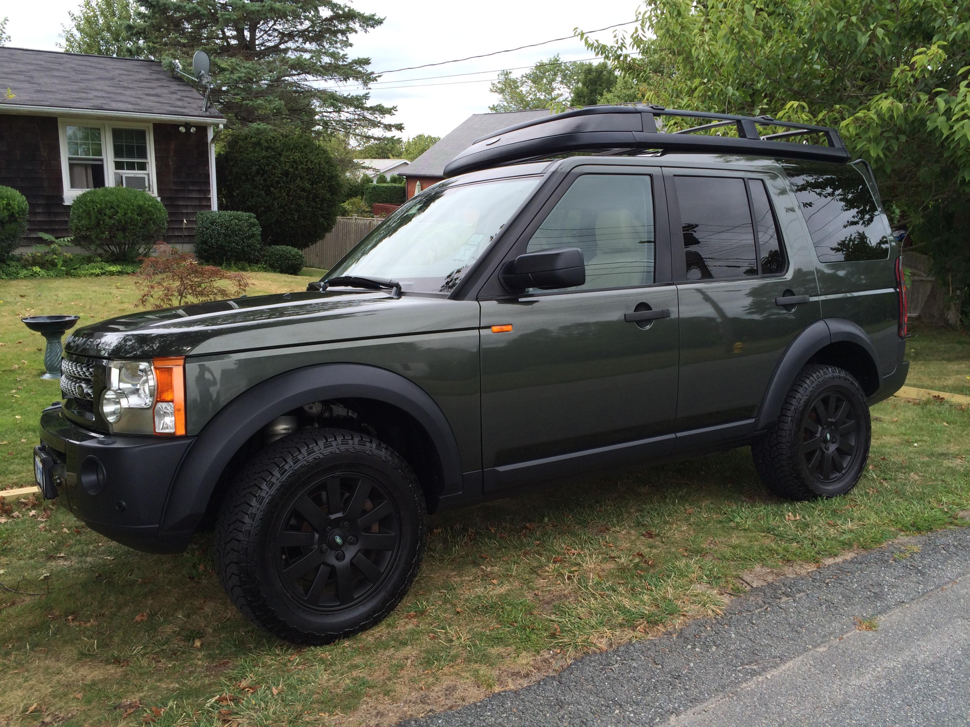

I got the hankook dynapro at rf 10 265/60/18 and they are amazing so far. I've put about 13,000 miles on them and they still look new. They also come with a 50,000 mile warranty. I'm also running rock armor height rods which raises my truck 2 inches higher than stock and the wheels fill up the space nicely. I had the Nittos 285/60/18 and I felt they were a little to wide for the LR3. My Indie mechanic told me that the 265 width was better for the snow that we get up here in New England.

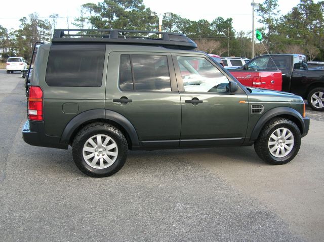

Pic number 2 shows the Nitto's I had and pre-plasti dip wheels.

That is a good look. My check engine light came back on. Will start another thread for that.
I wonder how long those rims will stay black?
