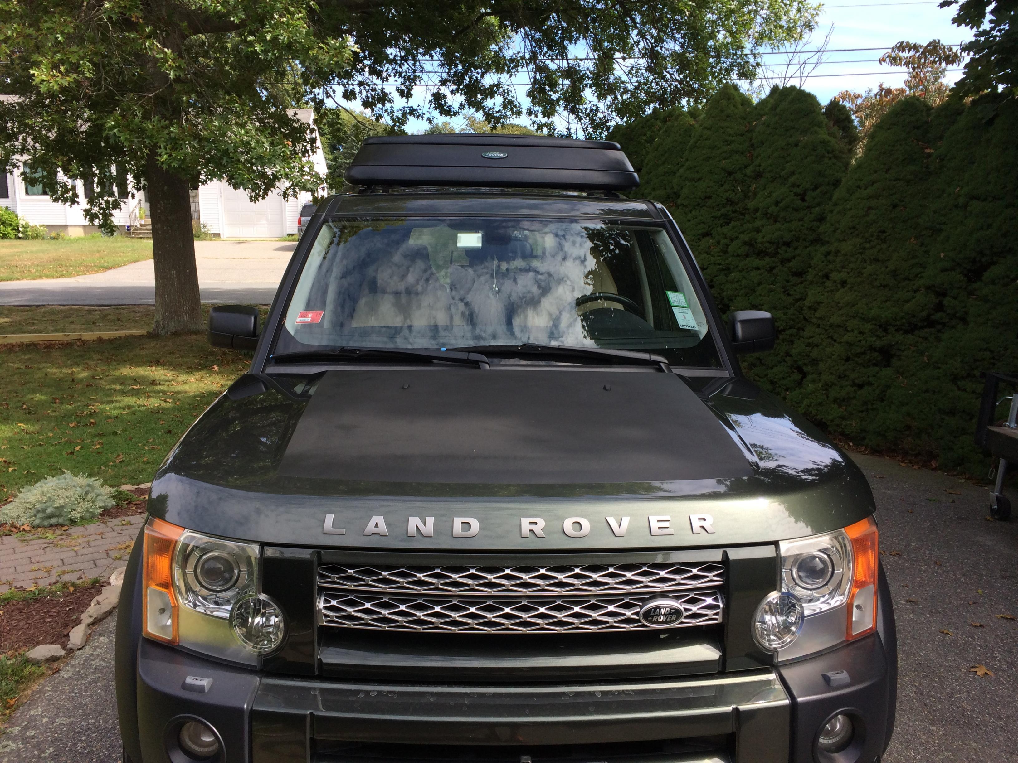

That is a good look. My check engine light came back on. Will start another thread for that.
I wonder how long those rims will stay black?
Do you have 265/60/18 as a spare? Does it fit easily?
I have the stock 19" doughnut as a spare, I need to get a full 18" spare and when I do I'll mount it on my roof rack. The tires been plastidipped in December 2013, so far they look fine 9 months later, the best thing about the platidipped wheels is that I can peel off the black if I want to go back to stock rims. I also recently plasti dipped my hood to black it out. Cost me under $8.00. It reduces the glare from the sun off my hood and protects it from the elements, mostly bird crap around this time of the year, but soon salt and dirt when winter arrives.
On another note I would definitely get a IIDTool first than tires like jwest suggested.
