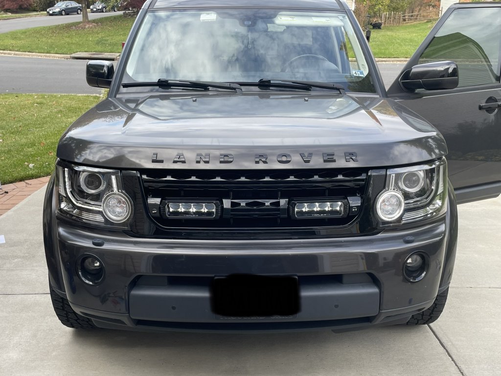

Wait. You wired the relay into the high beam signal correct? If so how come your aftermarket driving lights are on but not your highbeams?
The high beams are on. On the post-facelift headlights, the high beams and low beams are the same bulb.
The smaller light (inside the circle on the DRLs) is the turn signal.

I just upgraded to the 2014s and they are more than adequate for normal use. The aux lights are for off road use, like dune driving. If you said the halogens were bad I’d agree. I have never seen anyone complain about the 2014s.

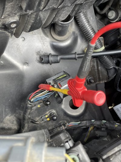

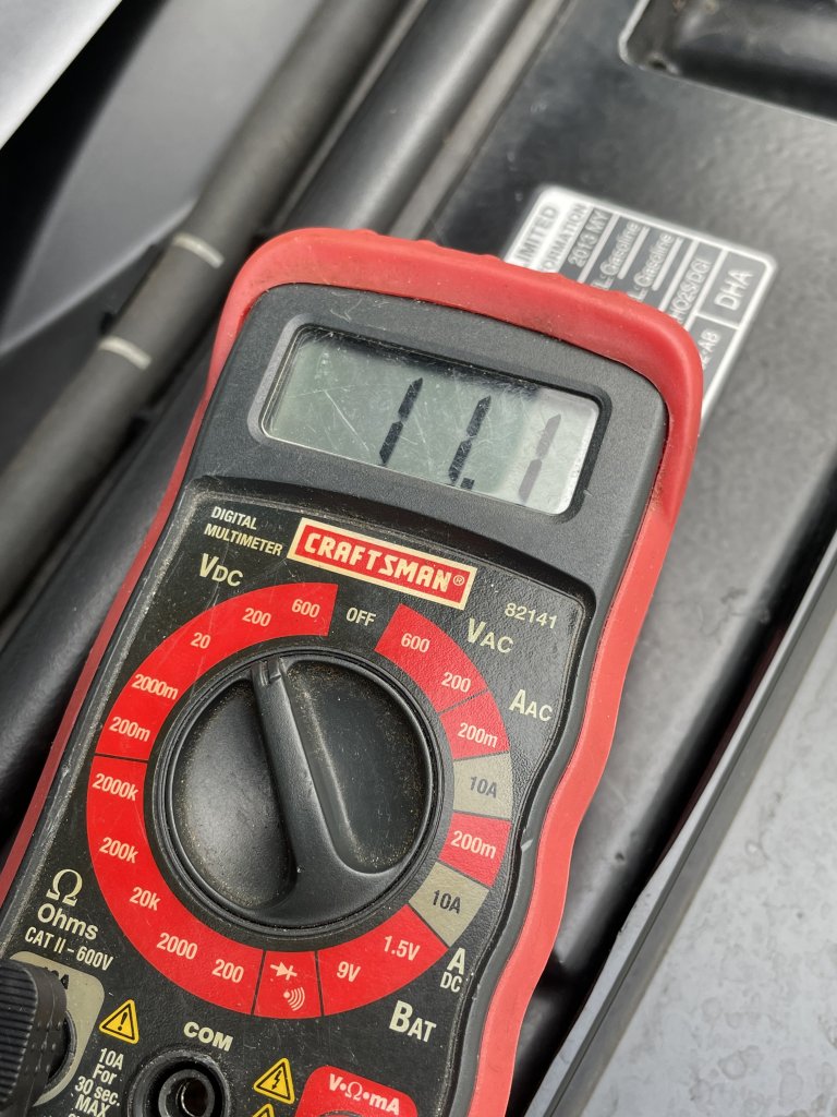

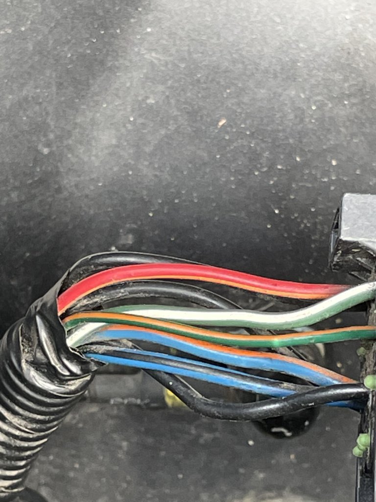

Since no one responded to my hunt for the DRL wire, it’s the red/orange one.
