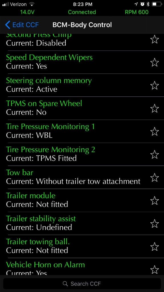

I just had my tires rotated today. They all went counter clockwise so now my spare is on the back right. The back left is now the spare. The system thinks my spare is the back left still and warns of low pressure since it is deflated to fit.
I get the same menu as above. Is there any way to redirect or rename the wheels properly after rotation?

Just FYI, and I hope the results are different for you as it may depend on model year, I turned off "TPMS on spare wheel" with my IIDTool years ago, and yet I still get the warning every time I start the engine (I have a MY2013). Thankfully, unlike the running wheels the spare tire's TPMS warning is designed to only stay on for a handful of seconds, then it extinguishes and doesn't come back until the next restart, so it doesn't bother me one bit. But yeah, the system should eventually figure out on its own where your sensors are now.

I think I’ve gotten myself into a weird spot. Before I rotated my tires the other day, I had a quick inspection done before a road trip we’re about to take. My tech turned off my spare tpms warning during this even though it didn’t bother me since it went away after a few seconds. Now that I’ve rotated the tires, I get a tpme system fault. The GAP tool threw two errors. One system and that indicated the tire indicator couldn’t activate.
Is there a way to get to square one with the GAP tool? I cleared the faults but the error still comes up on the dash after shutting down and restarting.
I may not understand how the GPA tool is supposed to work too. I’ve watched a bunch of the videos online but haven’t come across a tpms specific one yet.
Am I right in assuming my tech would have a more detailed access to settings than the GAP tool?

The dealer should be able to manually input the serial number of each wheel sensor to reset the system using his/her official diagnostics system - something you cannot do with an IIDTool (not yet, anyway.) They'll charge you for the service, but should be able to sort it if it's just a matter of your TPMS getting confused. Another thing you can try to do is to re-enable TPMS spare wheel monitoring with IIDTool and see what happens after some driving around? If the TPMS system fault sticks around, go back to the original setup (before the tire rotation - I know, it's a PITA to rotate tires once, let alone twice), clear the faults with IDTool and test drive the car again. It takes several miles of sustained speed for some of these faults to clear, so don't get discouraged if they pop back right away - they may clear on the their own while you are driving.
My understanding is that the TPMS will throw a fault if it cannot detect / communicate with a single specific sensor in your running wheels (indicating the trouble corner), but if it cannot detect two or more it will just throw a generic system fault.
Have you sent an email to the GAP team to see if they might be able to help? They are in a different time zone so they may not get back to you immediately, but they have been very helpful with me in the past and may have ideas for you to try.
