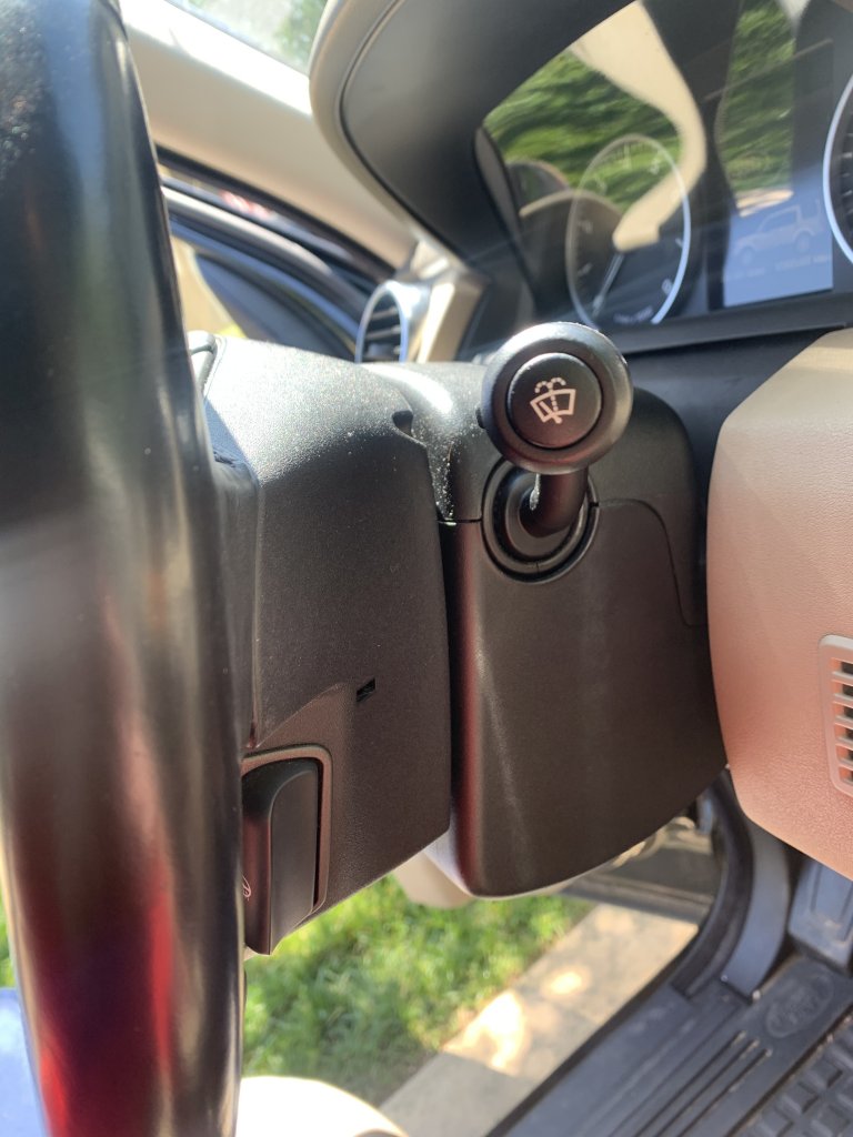

Not sure if the 2010 came with the paddles. I have e heated steering wheel but I don’t have the cable for the paddles on the back. Would I just have to replace the backing of my steering wheel or would I have to buy a completely new one with paddles. Here’s a pic.

For that one you could do just the backing with the paddles if you can find the entire assembly. I was not able to find that when i was looking so I ordered the entire steering wheel minus the air bag.
